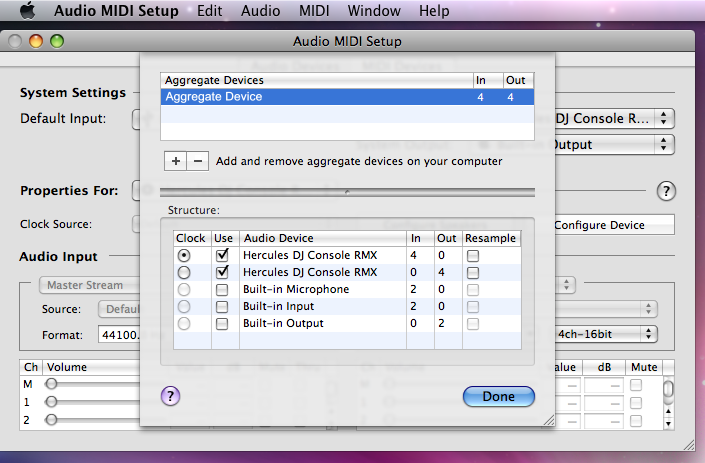

im a satisfied user of the dj console rmx on my macbook for about 7 or 8 months now, and the whole system has worked perfect so far. but now, suddenly, i have a problem with the audio setup. here is a screenshot of my audio setup screen:  . as you can see, the in- and outputs are no longer on two different lines but they are combined in one line. until now, it was always working correctly and the in- and output were on two different lines, and i have tried a lot of things but i cant get it right. because of this problem, it is not possible to choose the "hercules dj console rmx aggregate" in the sound section of the system preferences. this also causes the fact that its not possible for me to use the console in combination with traktor.

As I expected, this problem is a little complicated to explain. The point is that, unlike in this screen in the picture taken from the article which you provided the link to, my audio/midi setup has the in- and outputs from the RMX in the same line, which you can see in this screenshot I made showing my current audio/midi setup, when I try to create a new aggregate device. This causes the impossibility of using my RMX as a decent MIDI-controller with Traktor.
Apart from that, I have read and followed the instructions in that article a few times now, but it remains impossible for me to turn back the actual settings, so the in- and outputs are still on the same line. Re-installing the drivers didn't help either, I have both re-installed the drivers from the cd which came with the console and I have installed the latest versions of the drivers which were put out last month. All these actions didn't help and I still haven't managed to solve this strange problem, which I believe nobody has ever experienced before because I can't find any articles or messages describing the same problem.

Can you try to aggregate in a new "Hercules DJ Console Rmx Aggregate" device:
- your DJ Console Rmx 4-4
- your Mac microphone input?
and let me know if VirtualDJ 5 DJC can start with it?
