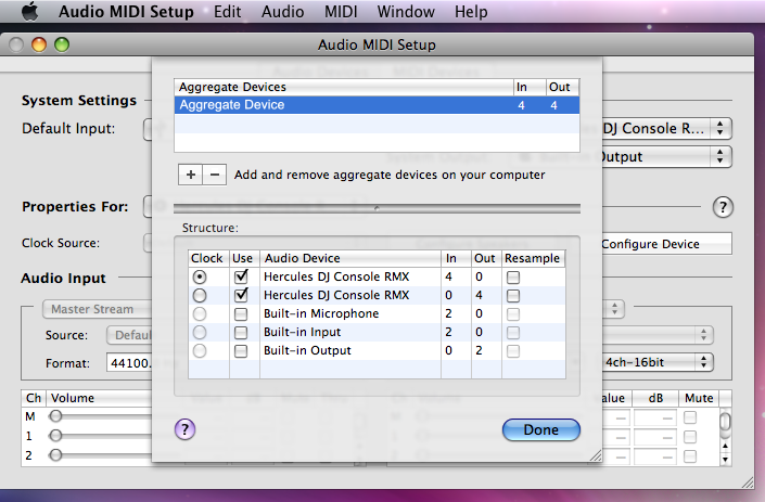

hi maxdjack,
first of all, i wanna thank you for taking the time and effort to help me.
as i expected, this problem is a little complicated to explain. the point is that, unlike in this screen in the picture taken from the article which you provided the link to, my audio/midi setup has the in- and outputs from the rmx in the same line, which you can see in this screenshot i made showing my current audio/midi setup, when i try to create a new aggregate device. this causes the impossibility of using my rmx as a decent midi-controller with traktor.
apart from that, i have read and followed the instructions in that article a few times now, but it remains impossible for me to turn back the actual settings, so the in- and outputs are still on the same line. re-installing the drivers didnt help either, i have both re-installed the drivers from the cd which came with the console and i have installed the latest versions of the drivers which were put out last month. all these actions didnt help and i still havent managed to solve this strange problem, which i believe nobody has ever experienced before because i cant find any articles or messages describing the same problem.
is this a better explanation of my problem? i know its impossible to expect you can help me now, but i am still hoping theres someone out there who has a solution..
anyhow, many thanks again for your attempt to help me out!
hi rebus,
can you try to aggregate in a new "hercules dj console rmx aggregate" device:
- your dj console rmx 4-4
- your mac microphone input?
and let me know if virtualdj 5 djc can start with it?

Hello Rebus,
I am not sure I understand your issue, but you should be able to re-create an aggregate device in following the process described in: http://www.virtualdj.com/homepage/Made_In_Breizh/blogs/3327/__8220_Error_in_the_Sound_Driver__8221____DJ_Console_Rmx___VirtualDJ_DJC_5___Mac_OS.html.
Maybe you should re-run the DJ Console Rmx driver installation.

Hi Maxdjack,
First of all, I wanna thank you for taking the time and effort to help me.
As I expected, this problem is a little complicated to explain. The point is that, unlike in this screen in the picture taken from the article which you provided the link to, my audio/midi setup has the in- and outputs from the RMX in the same line, which you can see in this screenshot I made showing my current audio/midi setup, when I try to create a new aggregate device. This causes the impossibility of using my RMX as a decent MIDI-controller with Traktor.
Apart from that, I have read and followed the instructions in that article a few times now, but it remains impossible for me to turn back the actual settings, so the in- and outputs are still on the same line. Re-installing the drivers didn't help either, I have both re-installed the drivers from the cd which came with the console and I have installed the latest versions of the drivers which were put out last month. All these actions didn't help and I still haven't managed to solve this strange problem, which I believe nobody has ever experienced before because I can't find any articles or messages describing the same problem.
Is this a better explanation of my problem? I know it's impossible to expect you can help me now, but I am still hoping there's someone out there who has a solution..
Anyhow, many thanks again for your attempt to help me out!
14 Answers
Hi Rebus,
Can you try to aggregate in a new "Hercules DJ Console Rmx Aggregate" device:
- your DJ Console Rmx 4-4
- your Mac microphone input?
and let me know if VirtualDJ 5 DJC can start with it?
