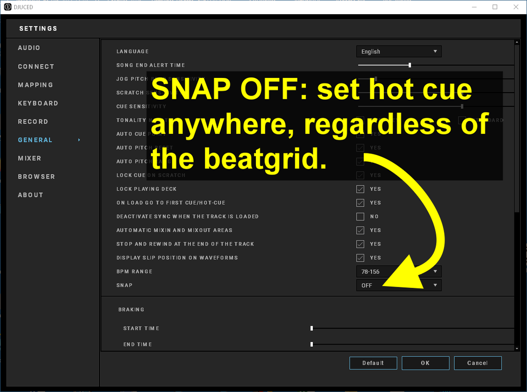

ive been using impulse 300, and whenever i put a cue of hot cue it always go to the next or last grid line/section.
please help me with this.
 the cue point isnt set exactly where i press it but rather at i guess you would call it section point? (the grid lines / sections thats all the way through any song in djuced) which is really annoying.... how do i change this ?
I guess you are using Djuced. In that software it's like that by design to help placing cue points. If you wish, you can disable this snap feature, just check the manual how to do it.
Welcome on the forum.
As you have a DJControl Inpulse, I suppose you use Djuced software.
The setting to disable the Snap function (which glues cue points to the beatgrid marks) is in Djuced> Settings > General
