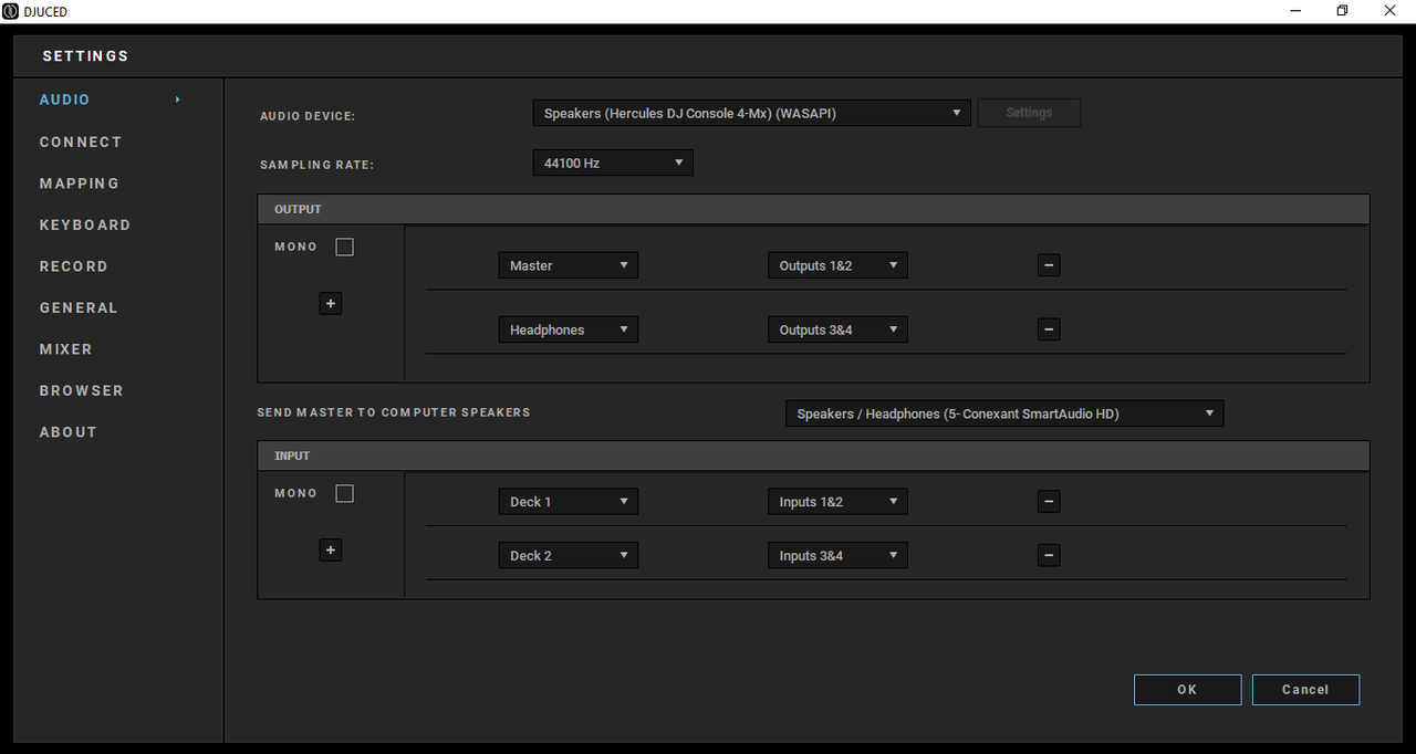

Can you detail the configuration you used in Settings > Audio for DJCUED ?
Djuced 5 Audio settings include an option "Send Master to computer speakers", so you can forget my suggestion to play channel 1-2 in headphones to use ASIO4All.
1) Set your DJ Console 4-Mx in WDM (Wasapi) in Hercules control panel
2) Run Djuced, go in Djuced Settings > Audio
- As Audio device, select: Speakers (Hercules DJ Console 4Mx)(WASAPI)
- As Master, select Outputs 1&2
- As Headphones, select Output 3&4
And in the option "Send Master to computer speakers", select your computer built-in sound card.
hi. i have done this. i hear the tiniest of sounds in my headphone when i scratch on the deck that i am cuing, but no other sounds. any ideas? i have tried different headphones.
i have uninstalled the drivers etc. and reinstalled. all settings are like the below.
