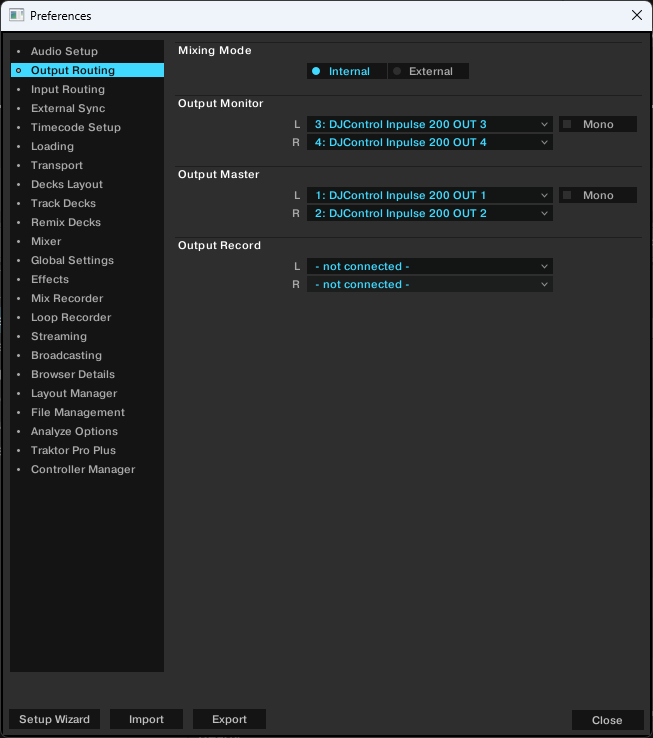

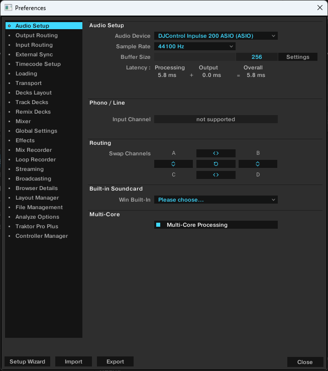

Enclosed are Traktor audio settings with DJControl Inpulse 200
1) Audio Setup
Audio Device: DJControl Inpulse 200 ASIO (ASIO)
2) Output Routing
Mixer mode: Internal
Output Monitor: DJControl Inpulse 200 Out 3 & 4
Output Master: DJControl Inpulse 200 Out 1 & 2
The forum efficiency depends on your providing clear and detailed technical information, so please also describe where your audio cable is connected (for example: from DJControl Inpulse 200 Master output RCA connectors to your speaker 3.5mm jack Aux input).

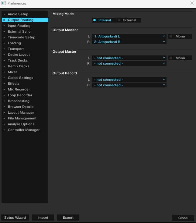

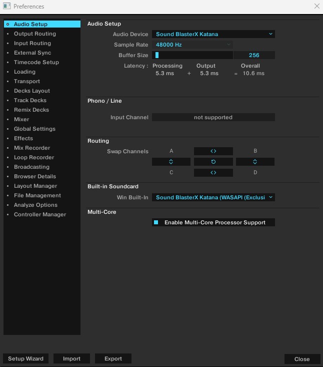

Hi, below are the screenshots of my current configuration, specifying that this is the only way I hear the sound from the external soundbar but, as I said, not the headphones. I connected a 3.5 rca jack cable from the impulse 200 output to the aux input
of the soundblaster, but nothing happens even when changing the channel to aux of the soundblaster. Could it be that the cable I bought doesn't fit? thanks for the courtesy.
Sorry but as long as you set your 2.1 speakers as Traktor audio device, you should expect the DJ controller headphones output to play any sound.
To get sound in your DJ audio outputs, you need to set the DJ controller audio as audio device in Traktor.
