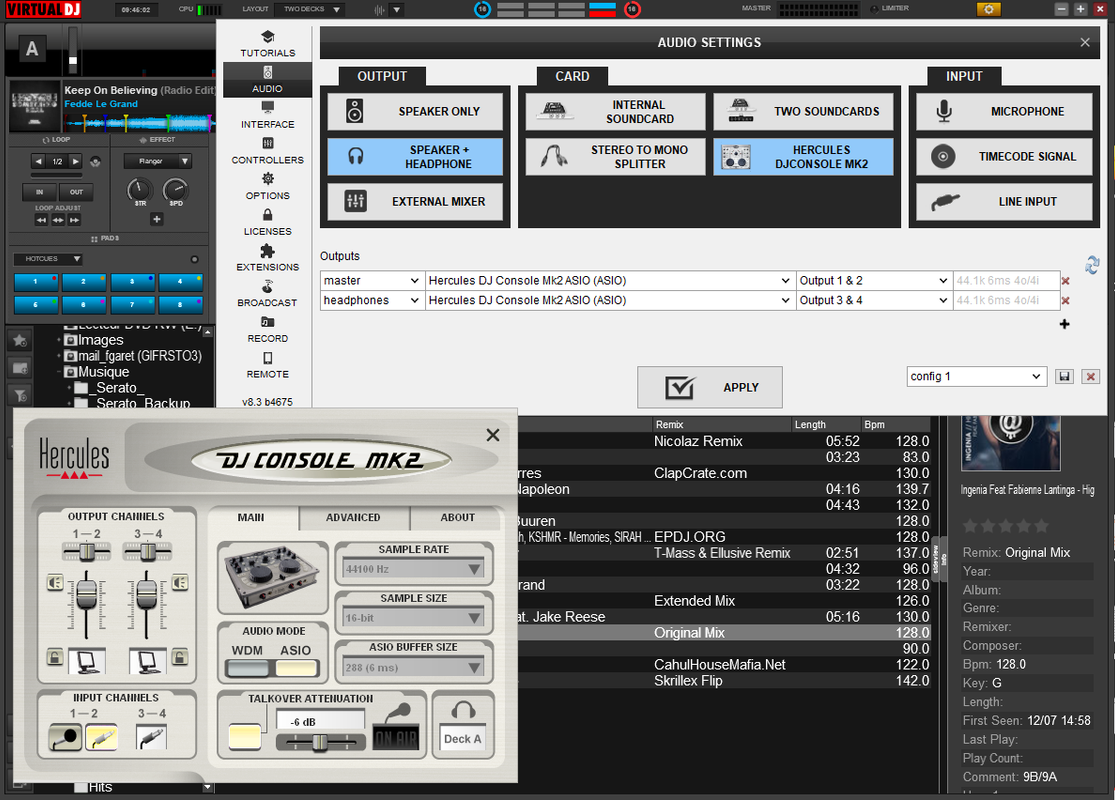

- Split and Mix position for the headphones output mix in hardware mix the streaming played on audio output 1-2 (so it not software dependent),
- Deck A and Deck B positions for the headphones output play the software streaming defined as output 3-4
so in my opinion, you should check in VirtualDJ > Config> Audio Settings if you have assigned DJ Console Mk2 Output 3&4 to headphones output.
