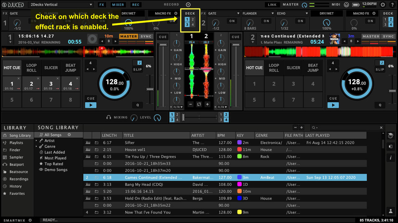

Hello Sideways2k,
Welcome on the forum.
Can you check on the right of the effect rack 1 that it is enabled on deck 1-3?
