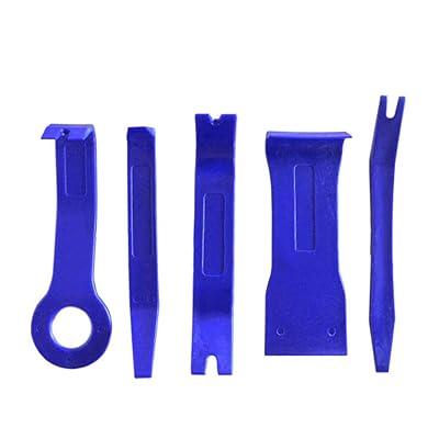

My cap remover is a nylon pry bar or crowbar as this type of tools:
https://www.amazon.co.uk/XWB-Auto-Trim-Removal-Tool/dp/B07B6KQLLS/
https://www.amazon.co.uk/Langdy-Removal-Removing-Refitting-Upholstery/dp/B0757LLLWW/
https://www.amazon.co.uk/Grip-Nylon-Pry-Tooling-Set/dp/B00SGJQSL2/

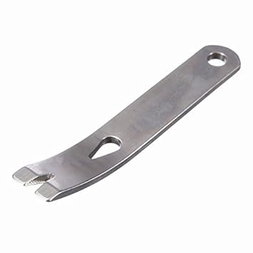

I have also seen people use metal crowbar/prybar as the following one, but a nylon tool is better as nylon will not damage the controller top panel while a metal crowbar car may scratch the surface or the paint of the controller.
https://www.amazon.co.uk/Portable-Pry-Crowbar-Pocket-Tool/dp/B07BXSFS9X/

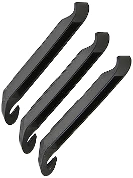

Some people also use bike tire levers to remove caps, but it is not as convenient.
https://www.amazon.co.uk/Silverline-127083-Plastic-Lever-3-Piece/dp/B007OX42X2/
