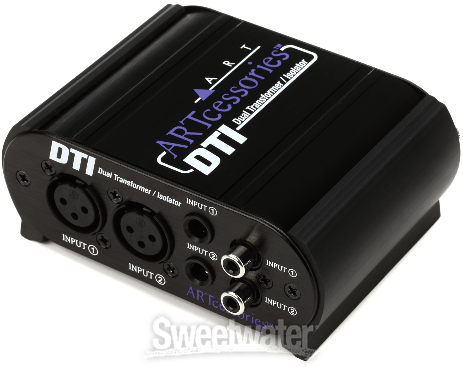

Solution B: connect between the Rmx audio outputs and the active speakers a ground loop eliminator, as ART DTI
If you mix in places in which you have not tested the power supply in advance, I suggest you always bring such devices with you, as you may alway meet ground loops.
