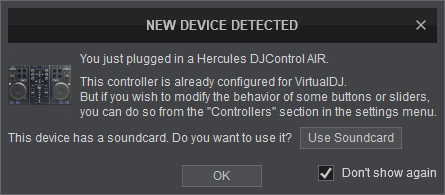

2) When you started VirtualDJ, did it detect the DJControl Air connected and display the following message:
New device detected
You just plugged in a Hercules DJControl Air.
This controller is already configured for VirtualDJ (...)
The device has a soundcard. Do you wantto use it?
Did you click on "Use soundcard" key and "OK" afterwards.
