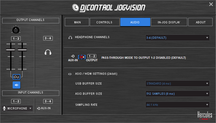

Before running Serato DJ Pro, please you call DJControl Jogvision control panel, go in the Audio tab:
A) If "ASIO buffer size" field is displayed in a brighter blue than "USB buffer size" and "Sampling rate" fields as hereafter
it means the driver is already in use by another program, so it will not be available for the Serato session.
B) If all audio fields (USB buffer size, ASIO buffer size, Sampling rate) have the same blue, as hereafter
it means the problem is somewhere else.
If you are in case A (ASIO buffer size" field is displayed in a brighter blue than "USB buffer size)
- you should check that no other program running is taking the DJControl Jogvision audio as default audio device (sometimes, when you close a program, it takes 30 seconds for the program to release the audio driver),
- if you do not see which program uses the audio device, you may unplug/replug the USB of DJControl Jogvision, see if all fields in DJControl Jogvision turn in the same blue, and once they are all in the same blue, run Serato DJ Pro.
If you are in case B, with all fields of the audio tab of DJControl Jogvision control panel in the same bright blue, then the case is different, and I have no clue at this moment of why you get the Serato message.
Please let me know what you see in the DJControl Jogvision control panel at the audio tab.
