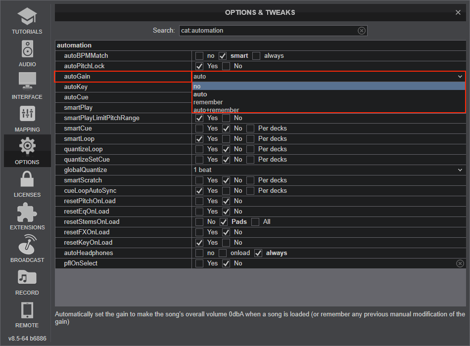

If VirtualDJ gain knobs turn on the screen when you trun the Gain knobs on DJControl Inpulse 300, then the DJ controller does its job.
In my opinion, you probably have an Autogain setting ON.
If you want the DJ controller to control the Gain, I suggest you disable the Autogain.
Run VirtualDJ > Settings > Options > Automation > and replace "autoGain"= auto by no
