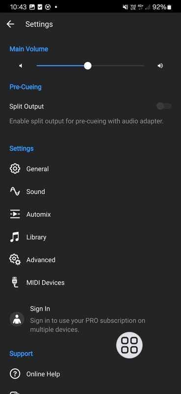

Can you confirm if, to pair in djay app, you follow the following process:

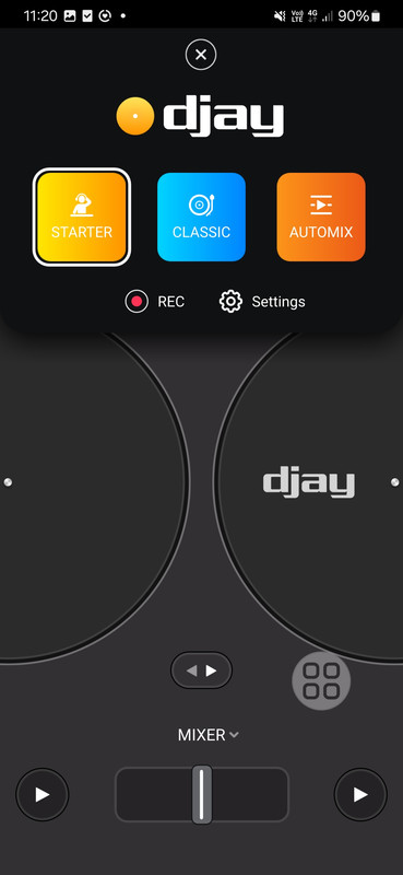

1) At djay first screen, you press on the gear icon (Settings)
2) In the settings, you press on MIDI Devices

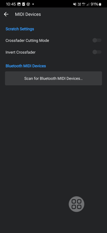

3) In MIDI Devices menu, you press on "Scan for Bluetooth Devices"

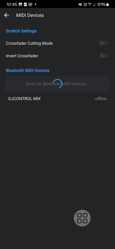

4) When you press on "Scan for Bluetooth Devices", djay detects DJControl Mix as offline

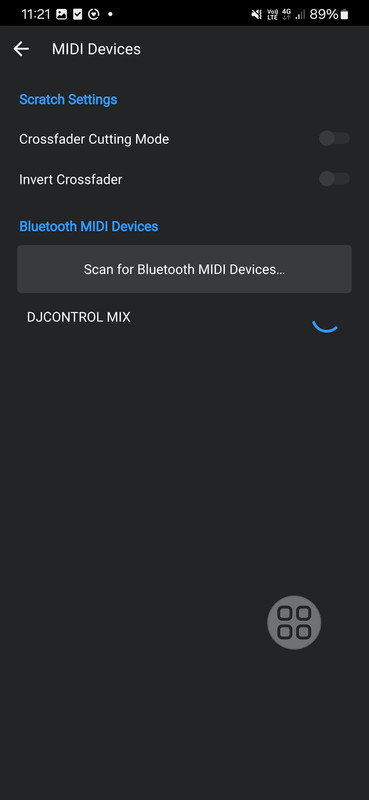

5) Then you press on "DJCONTROL MIX" name

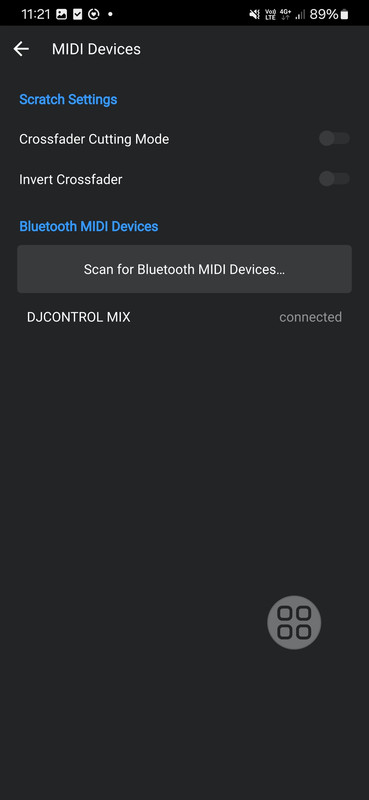

6) Then djay changes the status of DJCONTROL MIX into "Connected".
Yes, exactly. Ive used now a weaker USB charger and bluetooth button is now flashing white and and I could comnect to djay app. With stronger adapter all buttons stayed lightened up, even bluetooth stayed white and connection didnt work. All fine now.my 65watt adapter seemed to be the issue.
