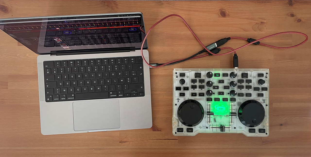

Hello Zeus,
The DJControl Glow is connected to the Mac with a USB-C adapter.
The USB-C to USB-A adapter is a Nimaso USB-C to USB-A.
https://www.amazon.ca/Adapter-NIMASO-Type-C-Thunderbolt-Macbook/dp/B07TJ38SDW/?th=1
Regarding the USB hub you have tried, having no dedicated power adapter may cause your non-detection issue: DJControl Glow power consumption is lower than most USB audio device, but it is still a high power consumption compared to USB key or USB keyboard.

Thanks for the update (and the pic of your setup)!
I gave it another shot with a USB Type A (female) to USB Type C (male) adapter, and the controller is now working flawlessly on a MacBook Air M3 2024 with macOS Sequoia 15.2 and DJUCED version 6.1.1.
