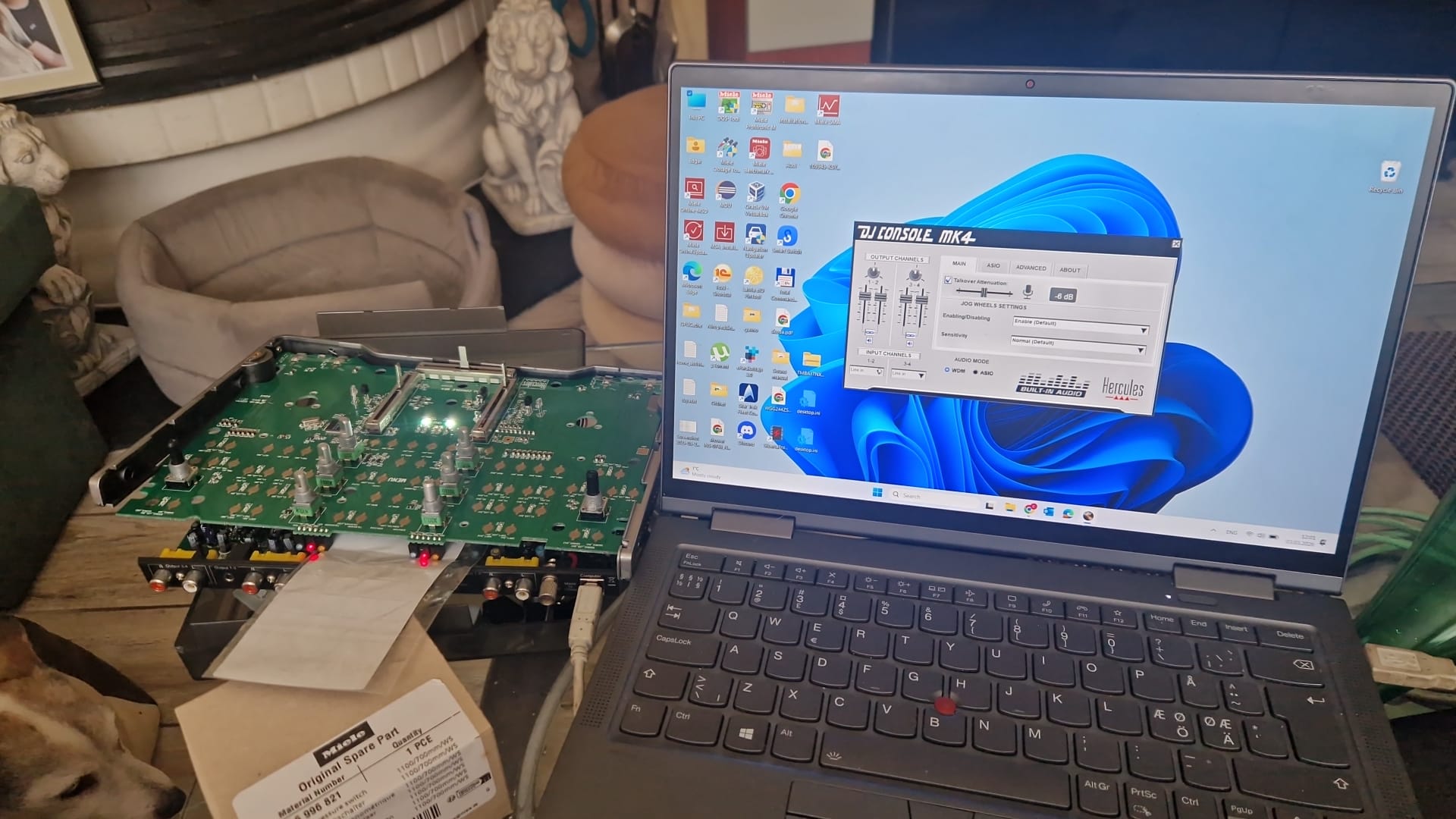

Buen día.
Necesito el archivo binario para reprogramar la EEPROM de mi MK4.
haciendo la actualización de firmware se quedó bloqueada.

Good afternoon, I have had a Hercules mk-4 console for a long time and now when I turn it on, I can’t initialize it on the computer. Unfortunately, I don’t have access to computers with the old operating system, but I have a programmer and I have the knowledge and ability to program the flash memory directly, so could you send me the latest firmware for this console?

Thank you very much for your attempts to help, but unfortunately my new version of Windows11 does not see Hercules by usb (say - device not recognised) and I cannot connect to it. Therefore, in my case, it would be easiest to get a Bin file that I will directly flash into its memory.

"invalid device descriptor" in device menager. and, my notebook dont have a usb2 ports, only usb 3.1 My mk4  hasn't been launched for several years, so the software there is definitely old. That's why I'd like to get the Bin file to program the console's flash memory directly.

I have sent to Films a .bin file to update on an eeprom burner.

Thnk You, UX Team! after reflash my console working now!
