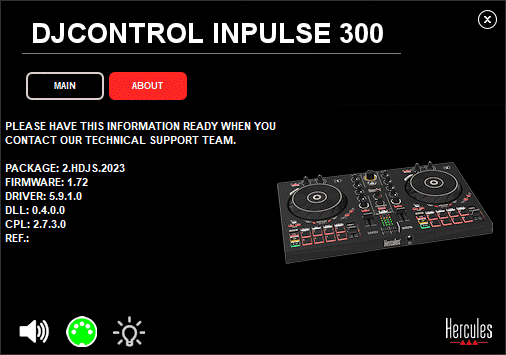

Can you
- close Djuced,
- run Hercules DJ control panel,
- go at the About tab,
- check if the MIDI icon on bottom left (between Speaker icon and LED icon) is green while you do not touch any control?
If it is green, the controller is sending MIDI commands by itself which shows a problem with the controller on the computer.
