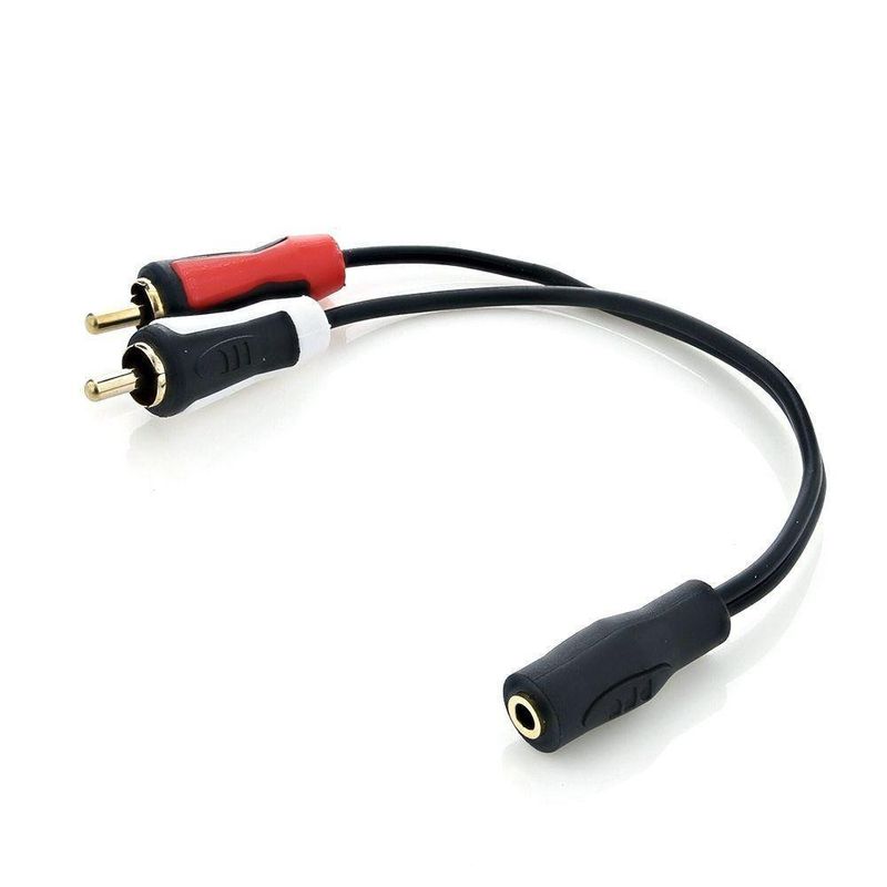

but now i have a really important question, can i use a rca stereo to 3.5mm plug to send the audio to the master? or it will create delay as well

all through the 3.5mm my speakers come with, but my question is if I use those speakers but using a RCA stereo to 3.5mm it will have delay as well? such as this one:
Yes, the dual RCA to 1/8" (3.5mm) cable adapter is probably what you need to connect your Z407 speakers aux input.
The 1/4" (6.35mm) jack outputs of Inpulse 500 are mono, so connecting stereo speakers on a mono output is not great.
