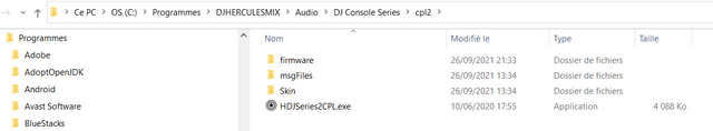

1) Can you go in the folder
C:\Program Files\DJHERCULESMIX\Audio\DJ Console Series\cpl2
and let us know which directories you see?
If the folder contents is close from being empty, then the control panel is not installed.

Here's the cpl2 folder:

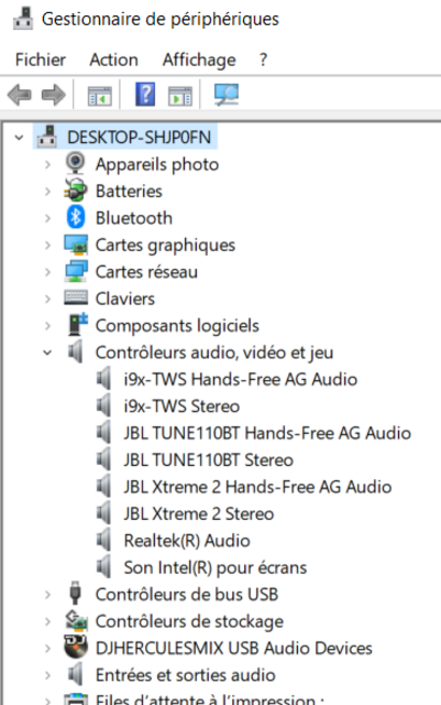

In Windows Device Manager, can you develop the groups
  • Contrôleurs audio, vidéo et jeu
  • DJHERCULESMIX USB Audio Devices?

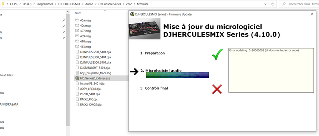

Tried on my other computer and getting the exact same error (CPL dialog box : "Script file not founded" etc...) and firware update failing.

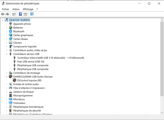

Here's the Device Manager unfolded:
I'm using Avast Free 21.7.2481 (version 21.7.6523.689)
Hi! I would try the firmware update without Avast (either disable it completlely for the time of the update or uninstall it).
Uninstalled Avast (and make sure that no more antivirus could block the update) but still getting the same result Cry

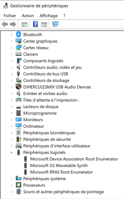

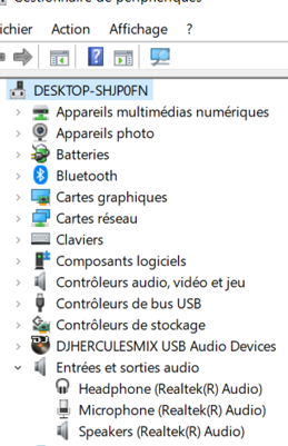

There are 2 issues:
1) System detection problem
Your controller is not full detected
- it is seen in DJHERCULESMIX USB Audio Devices group: GOOD
- it is not seen as "DJControl Inpulse 200" in Contrôleurs audio, vidéo et jeu: BAD
- is it seen as "Haut-parleurs (DJControl Inpulse 200)" in Audio inputs and outputs ("Entrées et sorties audio")?
- it is seen as "MIDI" twice in "Software devices" ("périphériques logiciels")?
It makes sense as the firmware is is not complete as the firmware updater cannot complete the firmware update.

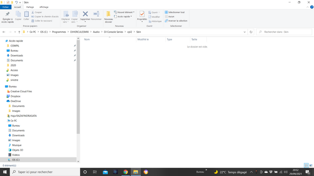

2) software installation issue: the script message looks like some files may be lacking in the folder
C:\Program Files\DJHERCULESMIX\Audio\DJ Console Series\cpl2\Skin\DJControl Inpulse200
There should be 49 files weighting 318 KB in this folder : => Is it what you get?
It is this skin error which lets me believe something prevents the installation.
If some files are not well written, it may also cause an issue withthe firmware updater.

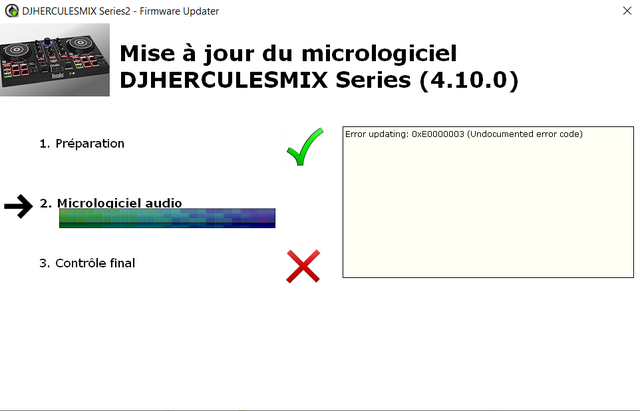

Done. I'm getting the same error right after launching the updater
This folder is emptyYell
Thanks for your message.
The good piece of news is that you have found the reason of the problem:
as the folder C:\Program Files\DJHERCULESMIX\Audio\DJ Console Series\cpl2\Skin\DJControl Inpulse200 is empty,
- the driver package is not well installed, so the control panel cannot work
- the firmware file is not well installed, so the firmware updating cannot work
- as the firmware updating has fails, the controller is not properly declared, and the system (and DJ software) cannot detect it.

Thanks for your reply.
So I finally found another computer without avast (windows defender disabled) and tried to update the firmware.
I'm getting the exact same error message (error 0x000003).

Thank you, I installed the 2020 package on my other computer (which I restored to factory setting).
I'm getting the same message while trying to update the firmware.
However, I noticed that this time, the controller is detected by the CPL and the firmware update is automaticly suggested by windows (on the other computer, I had to to open the "firmware updater.exe" file to launch the update).
Any suggestion please? I'm desperate

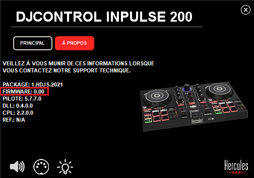

If you see the controller detected by the CPL, can you confirm
- if you see the complete DJControl Inpulse 200 CPL in that style?
- if you sees the CPL,
  • does the DIN 5 pin icon on bottom right of the CPL become green when you move a button on the controller?
  • do the controller LEDs light on when you click on the lamp icon on the bottom right of the CPL?
  • do you hear anything in the speakers (connected to the main dual RCA output) and the headphones (connected to the front 1/8" output)?
This is what the CPL shows :
Firmware : 0.00 Cry
Anything happening when I click on the lamp icon, same thing when a move a button on the controller.

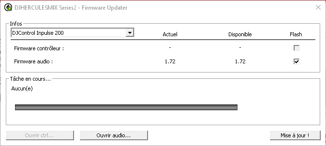

I guess you could try the manual way of flashing the firmware. Open a command prompt as an administrator and issue the following command:
"C:\Program Files\DJHERCULESMIX\Audio\DJ Console Series\cpl2\firmware\HDJSeries2Updater.exe" -manual
And proceed as the appearing window says. Hopefully this helps.

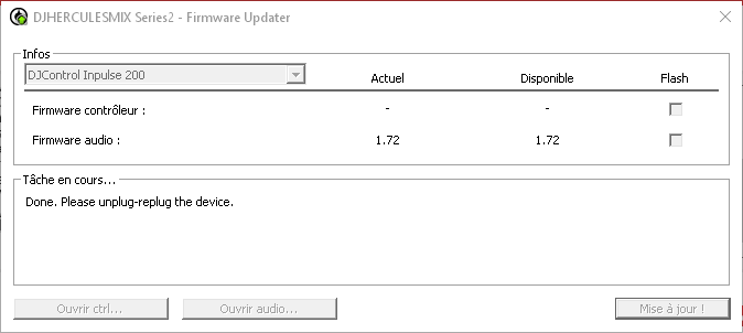

Hello Mix T,
I suggest is the following process:
  1. Run the firmware update on a PC without the Avast version which damaged the previous firmware update, with an administrator account of Windows,
  2. Go in C:\Program Files\DJHERCULESMIX\Audio\DJ Console Series\cpl2\firmware
    and check the file DJINPULSE200_S401.dja is installed and weights 65 664 bytes
  3. Close any software running on the computer except Windows,
  4. Unplug the DJControl Inpulse 200 from the computer,
  5. Press on DJControl Inpulse 200 Browser rotary encoder,
    keep the Browser pushed down
    and connect the controller to the computer USB port while the Browser remains down,
    let the Browser pushed down for 10 seconds after connecting the controller to the USB
  6. You can release the Browser button
  7. Right-click on Windows icon (bottom left of Windows screen), click on "Run"
  8. In the run field, type (on 1 line, with the ")
  9. click on OK
  10. In the manual updater, you can read which version is installed in the computer (here with the french menu of the firmware
  11.  updater)
12. Check the Flash field of line Audio firmware
13. Click on "Update!" button (Mise à jour for the french Windows)
14. At the end of the firmware update (which is very fast), close the firmware updater, unplug the DJControl Inpulse 200, and replug it. It should now be OK.
PS: DJControl Inpulse 500 has no eeprom to be reflashed (the firmware is embedded in the microcontroller), so it cannot be reflashed outside (on an eeprom burner) as on older generations DJ devices.

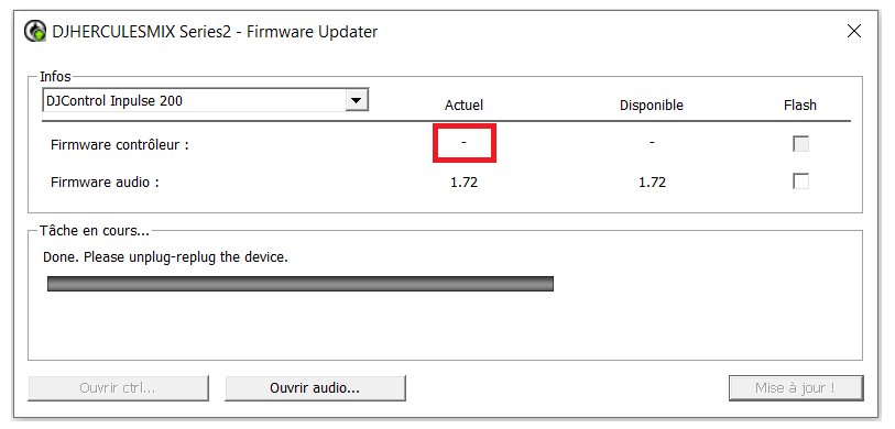

Thanks for your suggestion.
Yes, I've got the file DJINPULSE200_S401.dja.
I followed all the steps and ended up with the message like yours:
BTW, is it normal that it detects anything in the controller firmware line?
After I unplug and replug the controller, the CPL shows this
The controller is still not detected by VDJ.
With no antivirus and firewall activated
1) It is normal the firmware updater detects nothing on the line "Firmware contrôleur" as there is only 1 firmware in DJControl Inpulse 200.
This 2 line menu depends on the DJ controller chipset architecture: DJControl Inpulse 200 has 1 MCU chipset (combining audio and control surface), so there is only 1 firmware (some other DJ controllers have no audio, so the firmware is on on the line "Firmware contrôleur / some other DJ controllers have 2 MCU chipset, 1 for audio and 1 for control surface, and then there are 2 firmware).
2) Can you try uninstalling the 2021_HDJS_1 driver, re-installing the 2020_HDJS_1 drivers and reflash the firmware?
