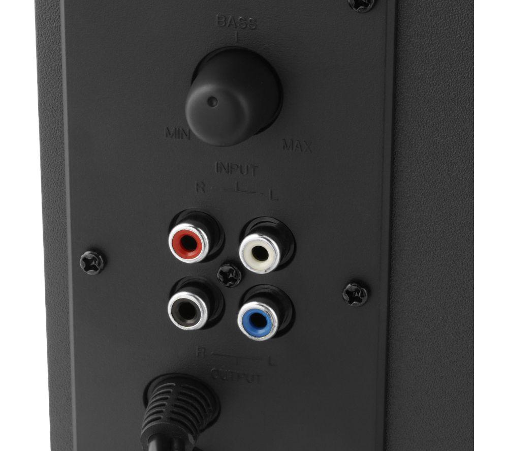

i have my logitech speakers plugged into the output on the subwoofer and the sub is plugged into the wall.
i then have an rca cable coming from the djcontrol inpulse 200 into the speakers rca inputs.
with spotify, youtube, windows sound tests, etc all of them come only from the left speaker.
there is a very faint right channel but it sounds like it is coming out of both speakers.
oh, and the subwoofer doesnt work at all.
my sound settings in djuced are set correctly, i even tried mono and that didnt work. windows sound settings are also set correctly.
as you can see on the back of the sub, they are all coloured differently too so i know i have them plugged into the correct spots.
any help in relation to the left and right channel would be amazing and if possible, the sub too!

2) When Z333 gets old, in playing sound on only 1 speaker is not uncommon, as explained in the comments of
I suggest you check 2 directions:
Direction a)  J.R Cabrera suggestion: insert a toothpick into Z333 control pod female 3.5mm connector
He had no sound in the right speaker, and the issue was caused by a defectiveness in Z33 control pod headphones connector, with a metal contact muting the speaker (as plugging the headphones mutes the speakers, a bended metal pin in the 3.5mm female connector may mute a speaker while no headphones are connector). His first test was insert a toothpick in the headphones female connector, and he found it restored sound on right speaker - afterwards he removed the defective headphones jack.
- remove the plastic cover of the input connector panel on the subwoofer and check the soldering of audio input plugs and volume rotary potentiometer + check the cleanliness of the rotary potentiometer.
The subwoofer vibration may gradually break the soldering of some pins.
