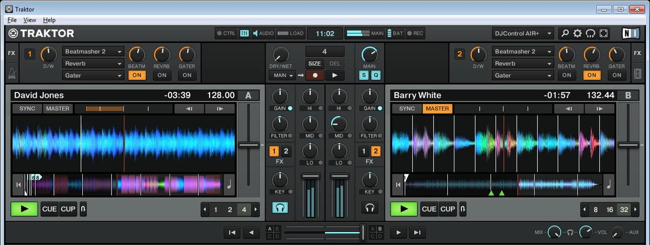

In Traktor Pro (tested on Traktor Pro release 2.9.0, with the TSI presets here), you must first use your computer mouse to
1) Load 1 effect per slot (as Traktor Pro offers much more than 3 effects, you must choose which effects you load in each slot) => As long as the slothas no effect, the DJControl AirPlus Fx button controlling the slot cannot light on,
2) Set, for each effect, the setting of this effet in the virtual potentiometer over the slot
3) Set, for the rack of 3 effects, the Dry->Wet setting (= how much of the original sound (dry), and how much of the effect (Wet))
Then, once you have prepared the 3 slots in the effect rack on left and in the bank on right, you can control the effects with the controller buttons 1, 2, 3, 4.
Button 4: switches on or off the full bank in assigning the fx bank to the deck or not: You can see in Traktor skin that
- on Left deck, the Fx button 4 sets on or off the full Fx 1 rack on deck A: with Traktor essential mixer display, you see it controls the button labelled 1 (Fx), between the key and the filter
- on Right deck, the Fx button 4 sets on or off the full Fx 2 rack on deck B: with Traktor essential mixer display, you see it controls the button labelled 2 (Fx), between the key and the filter
Buttons 1, 2, 3: they switch on:off the effects loaded on the slots 1, 2 and 3 of the fx racks.
