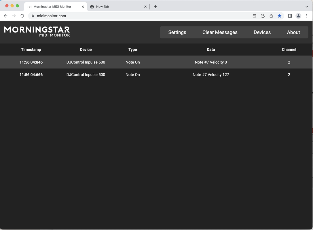

2) If Google Chrome installed on the computer, can you
- close the DJ software,
- run Google Chrome,
- go to midimonitor.com website,
- allow midimonitor to scan your MIDI device, it you are asked to
- and check the commands sent by the left deck play button
It should be
- a Note On #7 velocity 0 on channel 2 when you press the Play key,
- a Note On #7 velocity 127 on channel 2 when you release the Play key.
If you do not get these values, please test on another computer (PC/Mac) with midimonitor.com website (no need to install DJControl Inpulse 500 drivers, connecting it is enough) and if you get the same result, the key is defective so please contact Hercules technical support ( https://support.hercules.com/en/contact-en/ )
