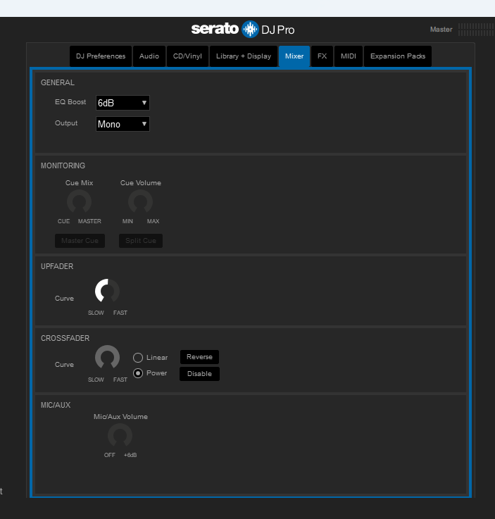

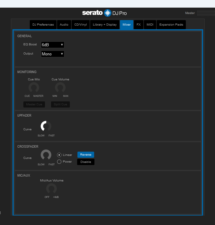

Serato DJ Pro 3.0.10 has added the standard crossfader options in the setup screen for the Hercules DJControl Inpulse 500.
If you have a Serato Pro licence, you can now, with DJC Inpulse 500 and Serato DJ Pro 3.0.10
1) set the crossfader curve in Power mode
2) or reverse the crossfader
as with other Serato DJ controllers.
