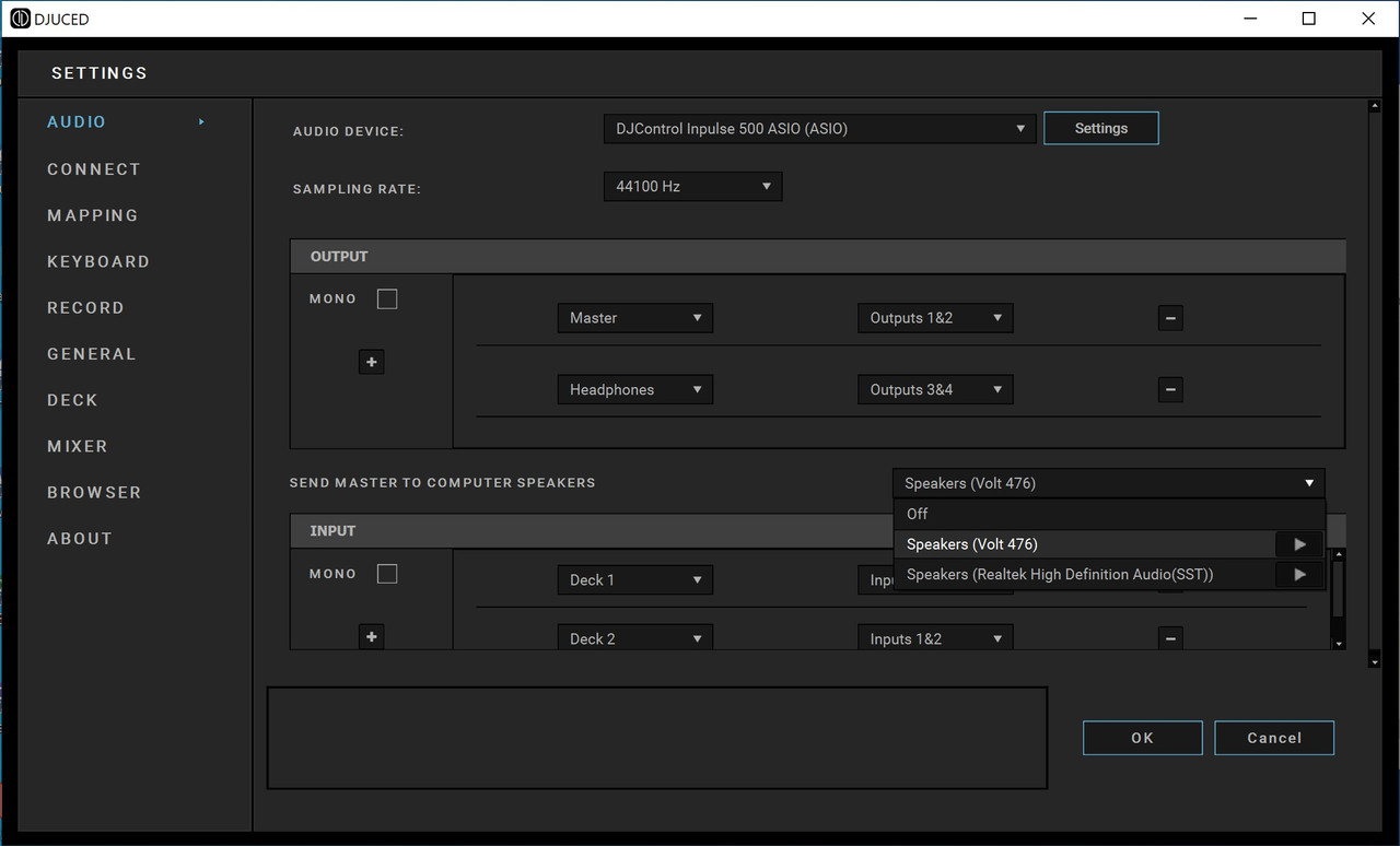

Hello jonx,
On my side, I have not the same issue as yours, I can select an alternate USB audio interface (in the screenshot, Universal Audio Volt 476) as output to the option "Send master to computer speakers"
But I am sure you did no mistake since, in duplicating this test in macOS 12.1, I got exactly the symptom you describe, I could not select the Volt 476 audio interface in Djuced field for "Send master to computer surface", while I could use the Volt476 as audio device in Djuced (in Djuced "Audio device" field, but not in "Send Master to computer speakers") and in Serato Lite in "Use Laptop speakers" setting.
