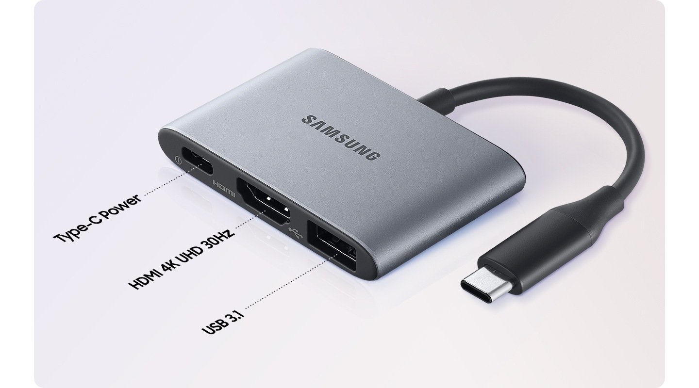

Connecting a DJ controller with built-in audio interface directly to the USB-C port of an Android smartphone or tablet will generally not work as most Android devices deliver a lower USB bus power than the 500 mA needed by many DJ controllers with audio.
To connect a USB device needing 500mA USB bus power, you should add power to the USB port, either with:
- a USB hub which has a power adapter, between the Android host and the USB device,
- or a USB adapter which has also a power input, and connect the power input while using the USB device, as for example
https://www.samsung.com/au/mobile-accessories/multiport-adapter-p3200-ee-p3200bjegww/
Another point to check is whether the Android host USB port is USB OTG (On-The-Go) = able to manage the Android machine as a host and the USB device as a device.
A simple test: if the Android host cannot recognize a standard USB keys as a data storage, the USB port is probably not OTG, and the solution is to connect a USB OTG adapter, like this
https://www.thomann.de/gb/thomann_usb_c_otg_adapter.htm
between the Android USB port and the USB adapter or USB hub.
