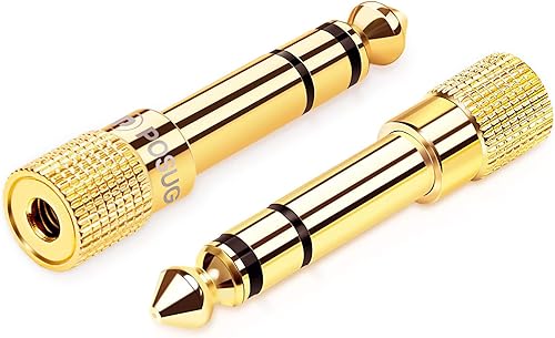

- If it is a good pair of headphones + microphones with an impedance > 16 ohms for the headphones, you cannot use the microphone due to its being bundled but you can use it in adding a jack 1/4" (6.3mm) adapter, and plugging it in the 1/4" (6.3mm) headphones output on front of the controller.
https://www.amazon.es/Adaptador-Posugear-unidades-Convertidor-Est%C3%A9reo/dp/B073NXQ35H/ref=sr_1_8
