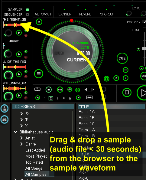

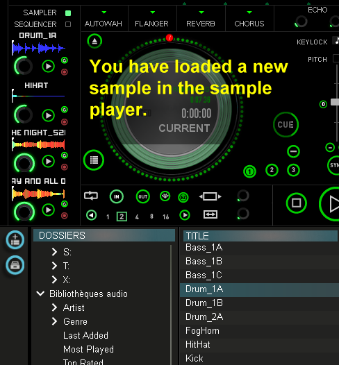

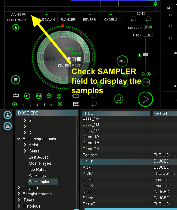

In Djuced 18, to change a sample:
1) Check Sampler field
2) Drag & drop a sample from the browser to the sample slot
3) And it is done, you have loaded a sample in the sample player.
