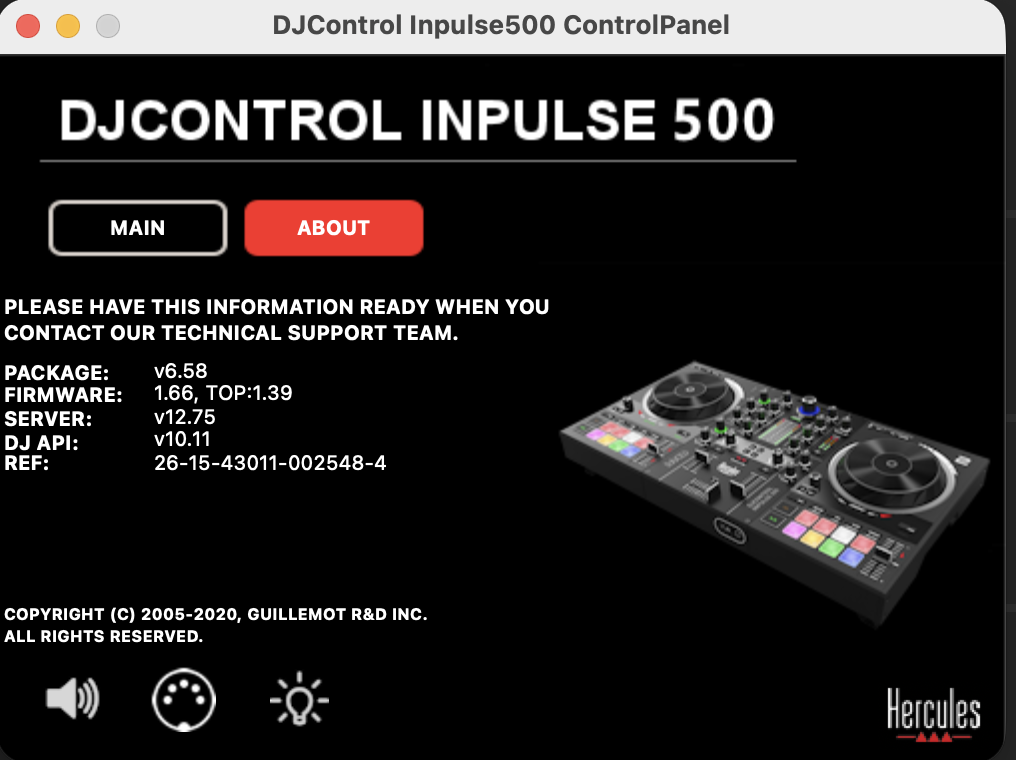

2) If you feel ready to write in a message on the forum
describing what you have
- version of Windows or macOS,
- version of Hercules DJ drivers if it is a Windows computer,
- type of Serato DJ Pro licence - flat Pro upgrade or Pro subscription or Suite subscription,
- version of Serato DJ Pro,
describing what you see on the screen when connecting the DJControl Inpulse 500
- in Hercules DJ control panel,
- in Serato DJ Pro,
then maybe someone can understand why on your computer "this controller does NOT work with Serato DJ Pro", and provide technical guidance.

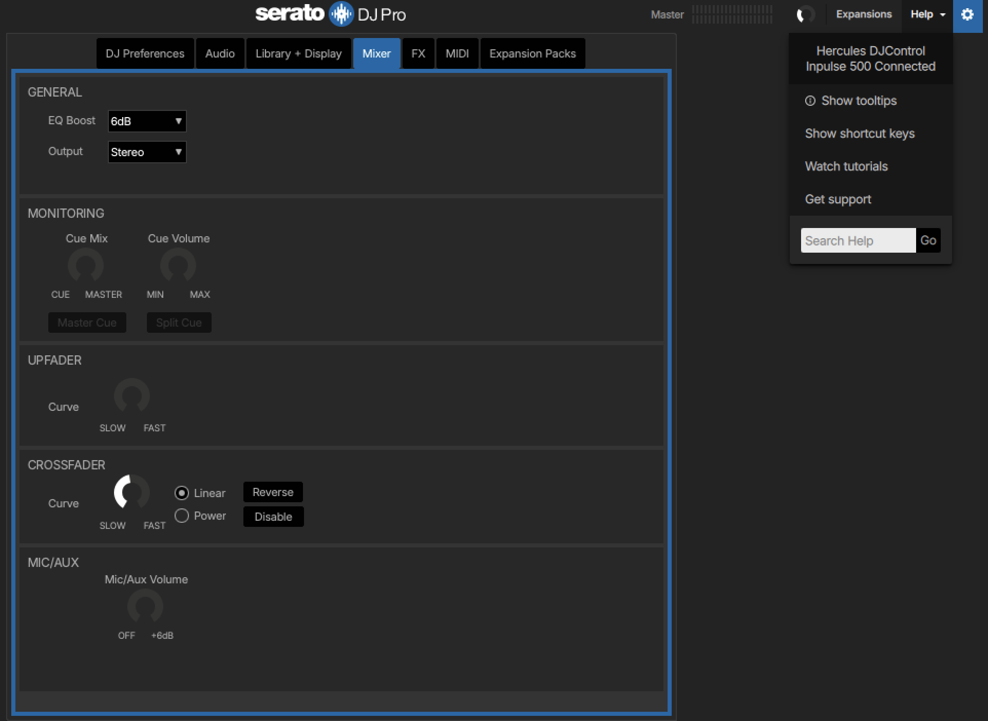

TODAY - I have a Hercules Impulse 500 controller that does not work 100% in Serato DJ Pro. The Mic Volume, Aux Volume, Cue-master mix, and cue volumes do not work. They are greyed out in Serato DJ. I have the screens shots.
Additionally, THE UPFADERs and CROSSFADER do NOT hold their respective positions - I set everything 12 o-'clock OR 50% within Serato DJ Pro and like to keep them that way.

Hello Chop-Chop,
DJControl Inpulse 500 following controls
  • Mic Volume,
  • Mic EQ
  • Aux Volume,
  • Aux Filter,
  • Cue-master mix,
  • Cue volume,
  • Master volume
are hardware controls, they are not processsed in the computer app, these commands are processed in hardware, in the embedded DSP and Codecs,
so they are not visible in Serato DJ: it does not mean they do not work, it means they work out of Serato (before for the inputs / after for the outputs). You may be misleaded because they also send a MIDI command, but it is just for users who want to map it on other functions.

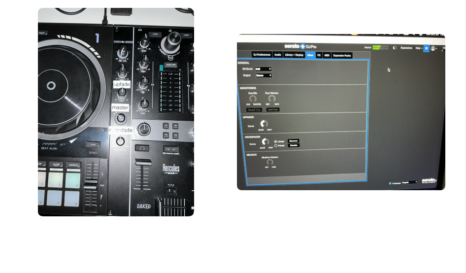

I mapped the aux filter knob to the crossfader curve.
I mapped the aux volume knob to the Serato DJ Pro master
I mapped the mic low knob to the upfader curve.
The aux volume to Serato DJ pro was the first one I mapped and it saves. I will see if the other two saved upon restarting Serato DJ Pro.
like this.
