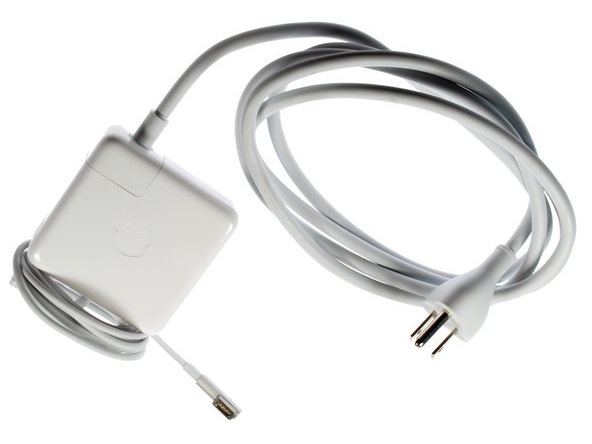

Hello BrunoLima,
If your power supply is not grounded, can you replace the plug part by the power plug with grounding
https://www.apple.com/shop/product/MK122LL/A/power-adapter-extension-cable?
https://store.storeimages.cdn-apple.com/4982/as-images.apple.com/is/MK122?wid=1144&hei=1144&fmt=jpeg
Hello BrunoLima,
Can you look at the power supply of your old MacBook of 2012?
If it had a 2-prong power connector, you have no power cable to take
but if it came with a grounded power cable
you may take the power cable and fix it on the power adapter of your new macBook to get a better ground.
