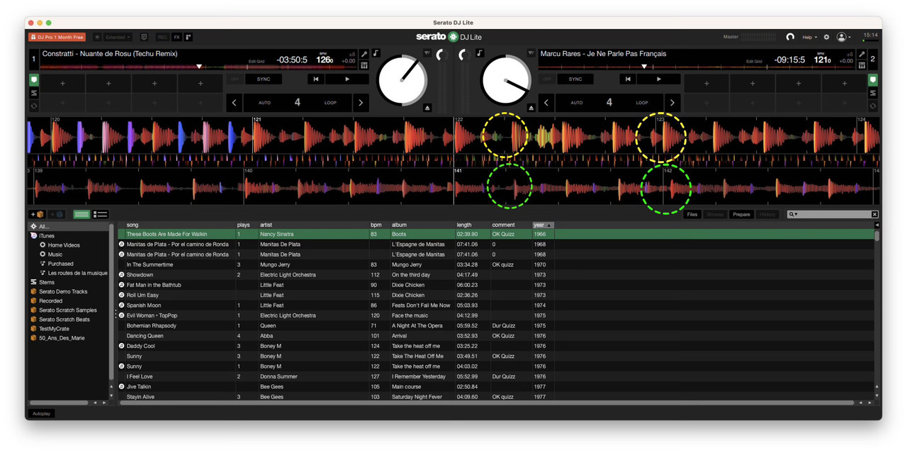

The 2 tracks you have sent have beat breaks soi avec the break, the grid is no longer aligned on the beats.
It is not related to Djuced, so I show the same occurs in Serato DJ Lite as you can see in the screenshot hereafter (the moment of the break in a circle.
The 2 solutions for a DJ
- short term: use the jog wheels or the platters to sync manually the track after the break, instead of using an auto sync
- long term solution: edit the track it in a DAW software (as Ableton Live, Logic Pro, FL Studio...) to warp the track = reset a fixed tempo on the full track.
To illustrate the example, I have warped your 2 tracks with a fixed tempo (you can download them for the remaining 6 days as I uploaded them  yesterday on wetransfer)
