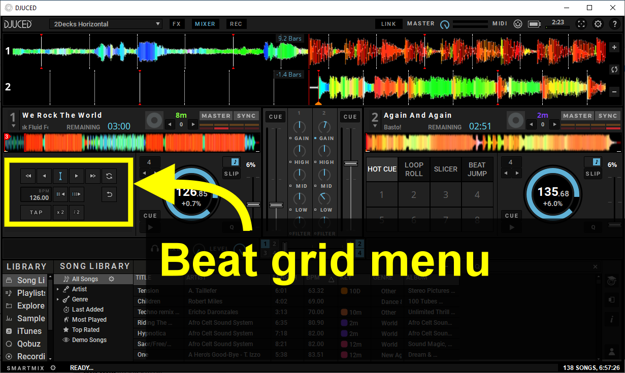

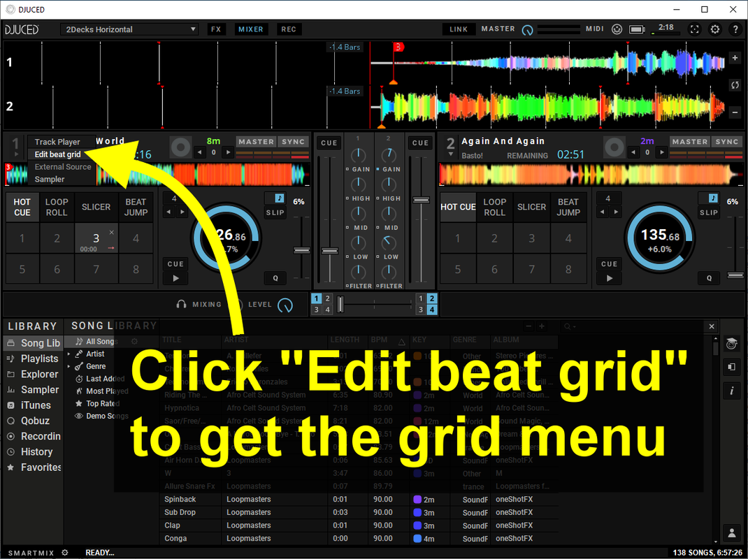

The way to edit the grid in Djuced is:
1) Click on the deck number,
2) Click on "Edit beat grid"
3) And you enter in grid edition menu, not very different from grid edition menu in Traktor.
