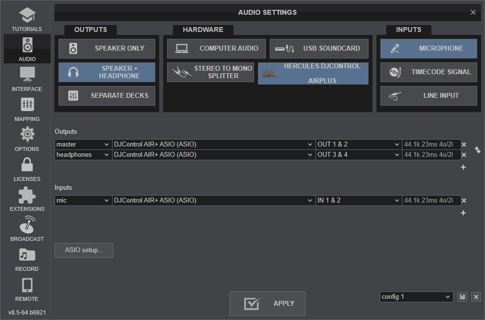

Here is the result of a test in today's VirtualDJ 2022.
1) In VirtualDJ > Settings > Audio
- in Hardware, select HERCULES DJCONTROL AIRPLUS
- In inputs, check Microphone
- As Mic, select "DJControl AIR+ ASIO (ASIO)" : In 1 &2

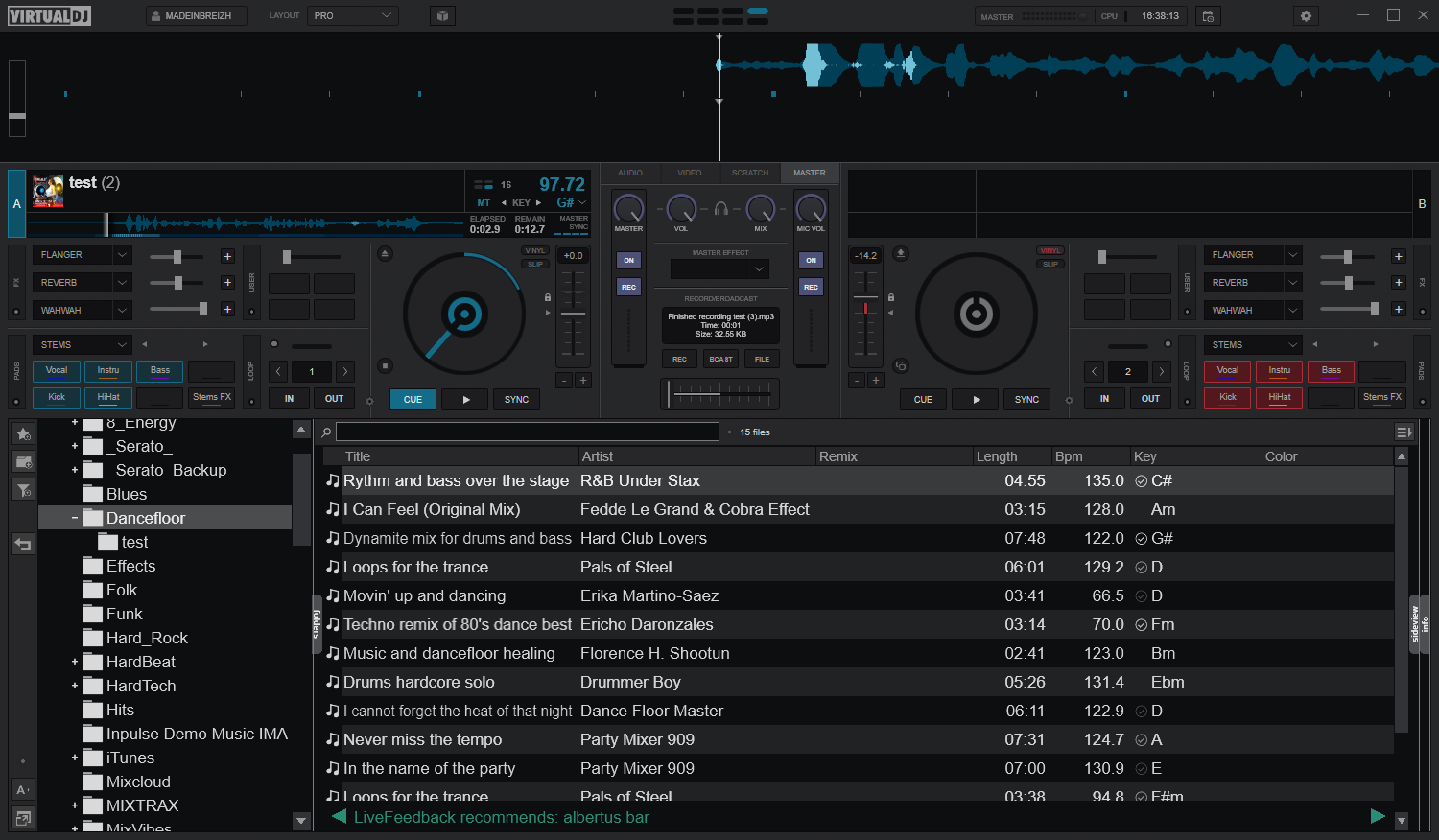

2) Then in VirtualDJ main interface, display the Master Mixer, and
in the MIC columns,
- set the MIC VOL to the max
- Set ON the MIC in this column, to hear the MIC,
- activate the REC button of the Mic (so that recording includes the MIC)
in the Master column
- Set the Master Vol to the max
- Set ON the master to hear also the master mix
- activate the REC button on the Master columns (to record also VirtualDJ Master)
and then you can Record when you want.
