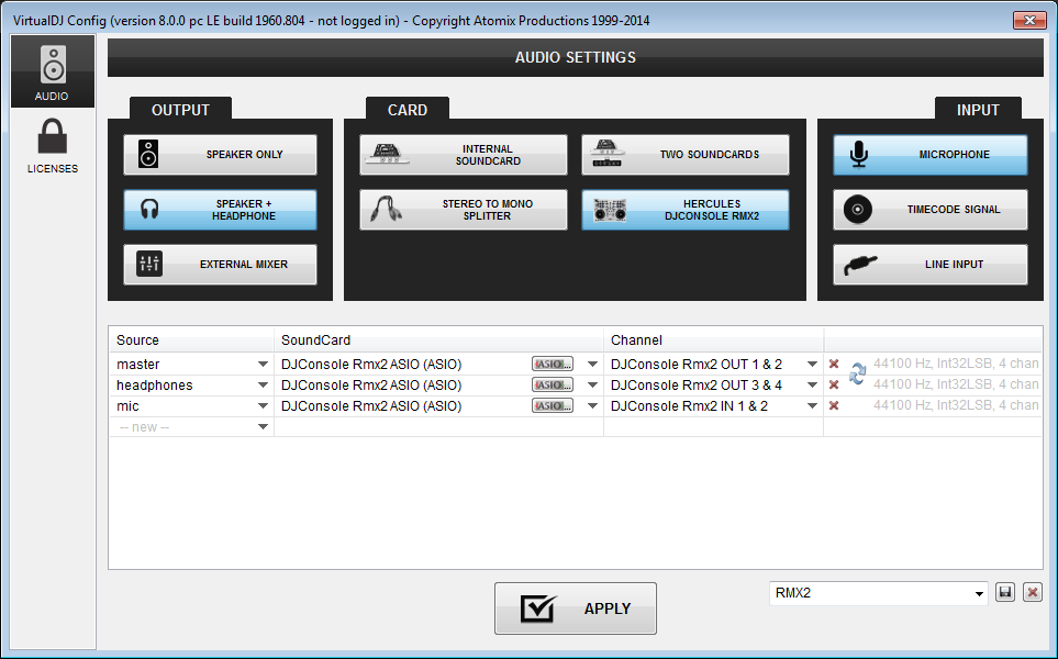

Hello Ajajude,
You can record the microphone input in VirtualDJ 7 or 8.
For example in VirtualDJ 8 LE > Audio settings
- Set Hercules DJConsole Rmx2 ASIO as sound card
- Output: speaker + headphone
- Input: microphone (using the channel DJConsole Rmx2 1 & 2)

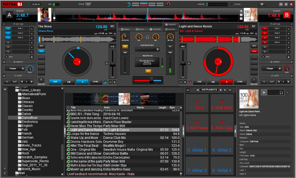

And then, if you activate the microphone input (with the button Mic On/Off on the Rmx2), and you record the mix (display the Master menu in VDJ mixer area), you record the microphone input in the mix.
When you use the microphone, you don't hear the microphone input in the headphones, whether you preview the mix or the cue, you don't hear the microphone input, but you know the microphone input is working because you see the microphone Vu-meter in the master menu.
