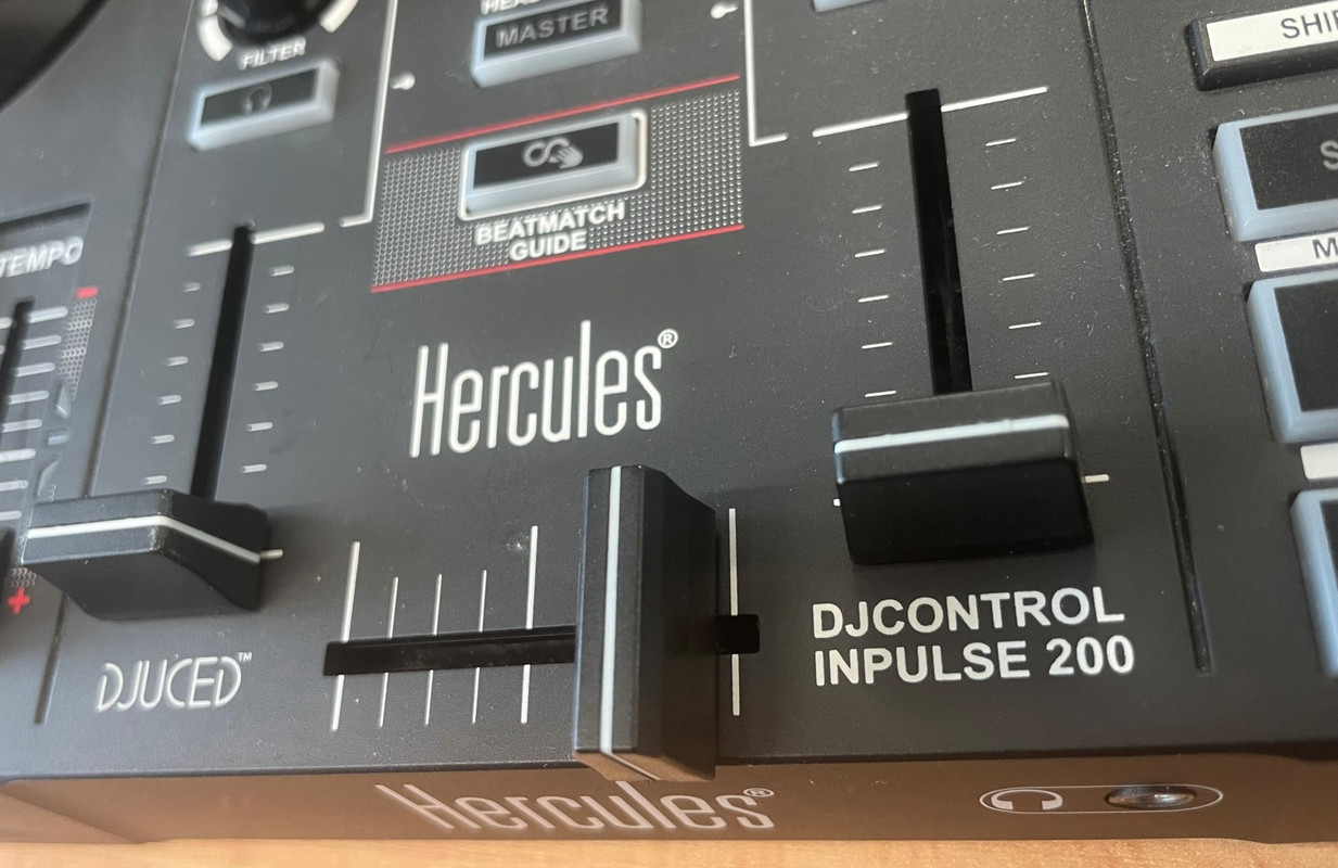

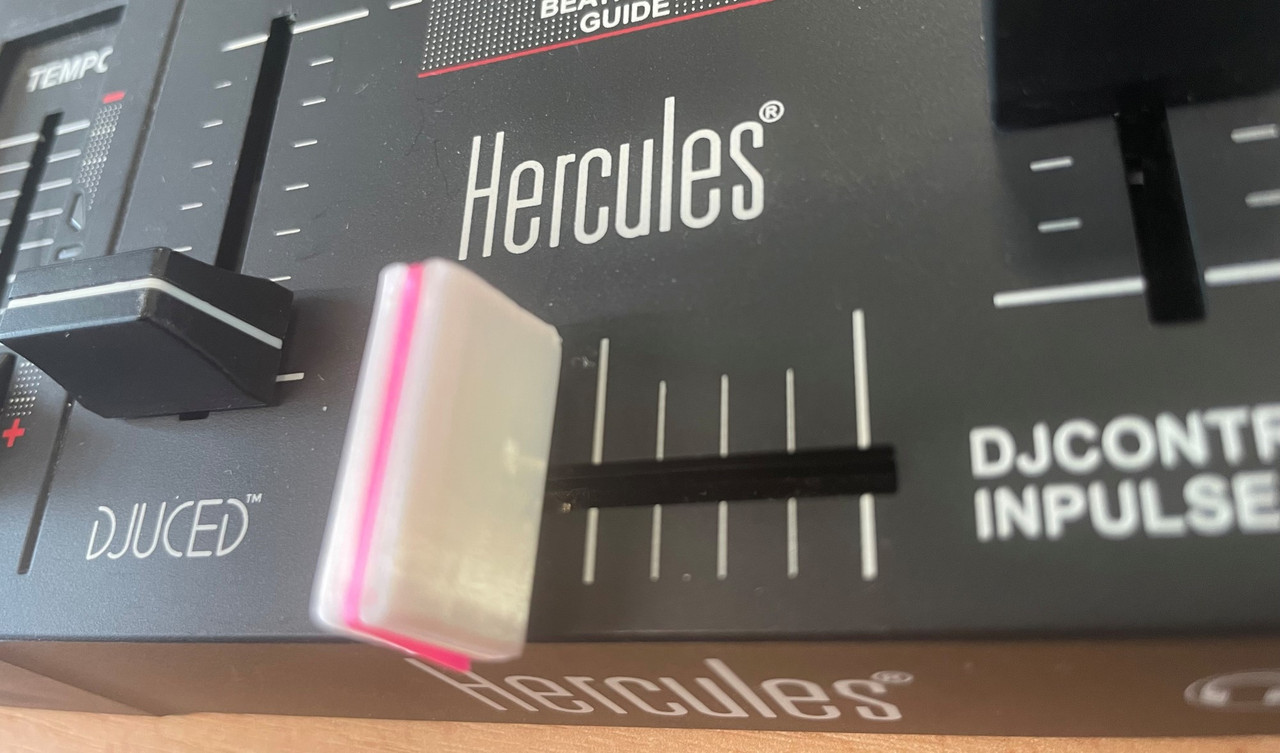

Regarding how Inpulse 500' s crossfader cap fits on DJC Inpulse 200 crossfader:
1) enclosed is a photo of DJC Inpulse 200 with DJC Inpulse 500 original crossfader cap: it fits well (it is larger & higher than the other fader cap, but is it comfortable)
2) enclosed is a photo of DJC Inpulse 200 with DJC Inpulse 500 crossfader cap printed in 3D: it still fits OK but as 3D printed caps may become less tight than original caps after some time, you may have to add a drop of glue on the fader shaft also with this cap.
