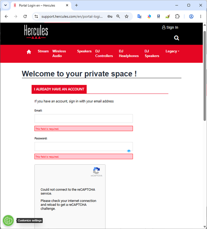

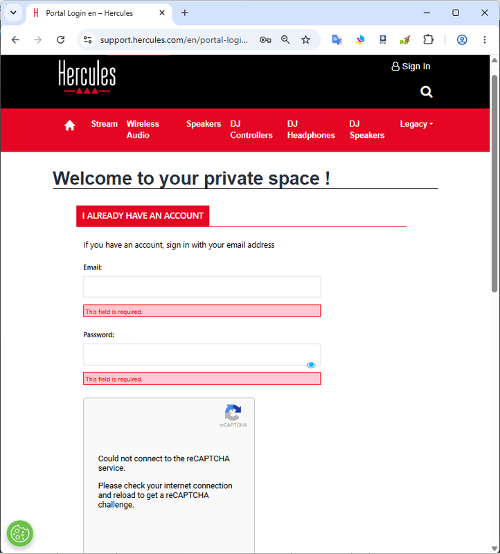

Additional note regarding official support
I am posting this in the public forum because I have been unable to open a support ticket through the official Hercules support website for several days.
The reCAPTCHA displays the following error:
“Could not connect to the reCAPTCHA service. Please check your internet connection and refresh the page to receive a reCAPTCHA challenge.”
I have tested the support website using several different devices, browsers, internet connections and locations, but the same error continues to appear.
Because of this issue, I cannot create an account or log in to submit an official support request. I have also been unable to find a direct Hercules technical-support email address, and there does not appear to be a Swiss support telephone number.
For these reasons, I am asking for assistance here in the forum.
9 Answers

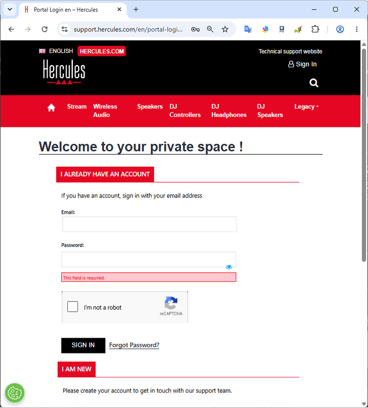

If when you try to sign in https://support.hercules.com website, you read the message:
Then you have set your settings for Hercules website in a way which refuses the conditions of the reCAPTCHA service.

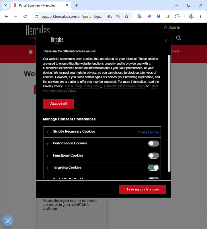

To change the cookies settings for Hercules websites, please:
1) Customize the cookie settings: click on the green circle with a cookie
2) In the cookie settings menu, accept the "Targeting Cookies" and click on "Save my preferences"
3) Then you can see the reCAPTCHA question: "I'm not a robot" and you can click on it to sign in.

Hello @MIBZIC,
Thank you for your help. After changing the cookie settings, the reCAPTCHA issue was resolved and I was able to sign in.
Unfortunately, I am now experiencing another problem when creating the support request. The page has been stuck on the loading screen shown in the attached screenshot for approximately one hour, and I am unable to continue or complete the request.
I have already refreshed the page and tried again, but the issue remains.
Is there perhaps an equally simple fix for this problem as well? 😄 Otherwise, could you please advise me how to proceed or open the support request manually?
Kind regards

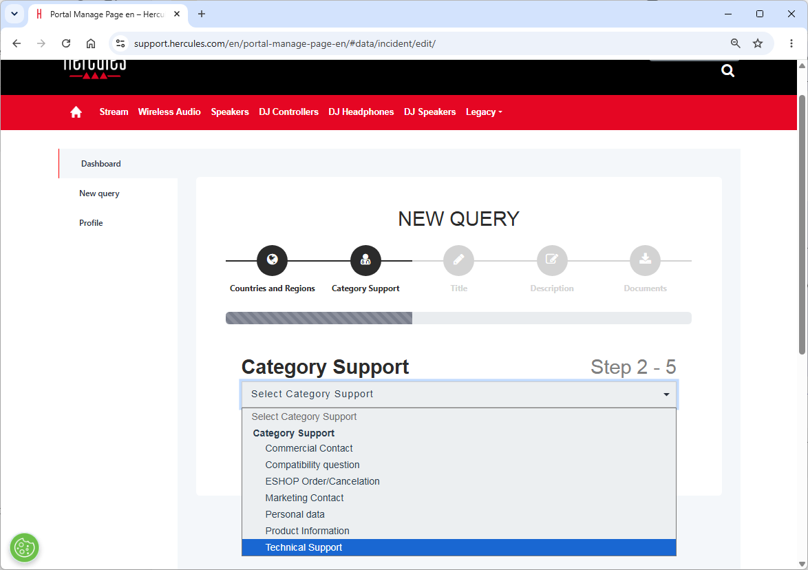

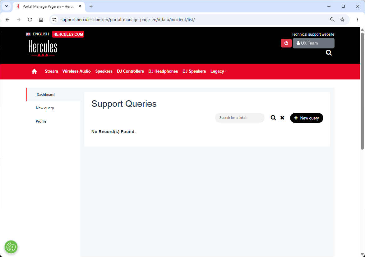

Please precise at which step you are blocked once connected to support.hercules.com website:
1) At the dashboard landing page

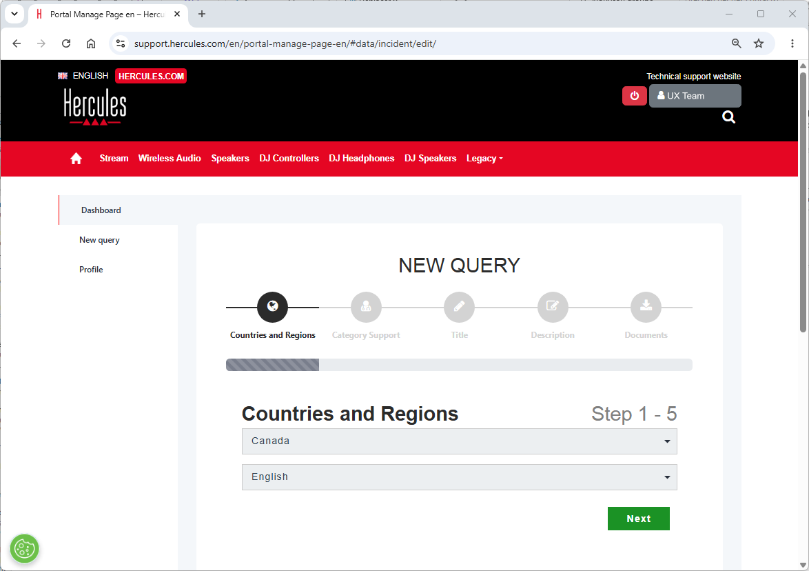

2) Or at the first page when you click on "New Query"
3) Or later, once you have set your country & language, when you click on Next
when you should select the category of your message

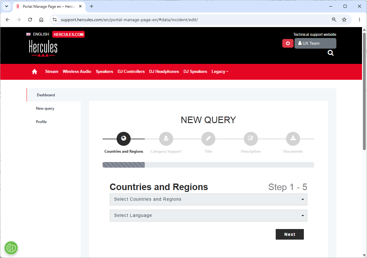

I am blocked at the final step, after clicking “Complete”. The page then remains stuck on the loading screen and the request is not submitted.
Screenshot:
