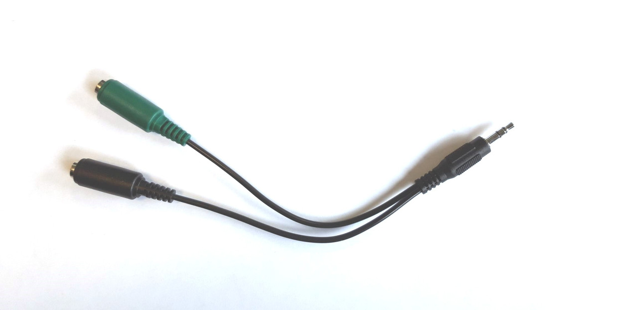

My headphones just work, when I put it "half" into the splitter cable?!?
If I put it full in=NO sound!
WHY, Whats wrong? In the DJ app, I have Split Output!
Cable defect?

Hello Dermidge,
Please confirm you use this cable
as in your photo it looks like a black connector, and it should be a green connector if you use the splitter cable enclosed in the box.
Please use a standard pair of headphones, with simple stereo jack connector (TRS connector).
I think you use a headset with a microphone, whose TRRS connector, which is not well supported in split cables.
Hi, thank you for the reply!
I use original splitter cable. Black connected to speaker. Green connected to headphones.
I use JPL headphones: No micro, but it has TRRS???

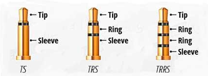

Hello Dermidge,
Your headphones has a TRRS connector because there is an inline microphone
You need headphones with just a stereo connector

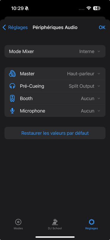

Hello Miura,
Welcome to this area,
Please
- go in djay Settings > Audio devices and check if the Pre-Cueing setting is actually on Split Output.
- precise your version of djay (Android or iOS, and version number: when you go in djay settings, the version number is at the bottom of the page, for example 5.1.6/
Is anybody able to help me? I bought used DJ control Mix, but unfortunately without oryginał splitter cable 🙁 can anybody check the internal TRS (splitter cable connection connection (splitter cable connection), and make a simple electrical drawing?
Or maybe has anybody info, wher to buy working splitter cable?
Best regards.
Hello Bonius,
The DJ splitter cable electronic schematics is pretty simple as you come split a TRS jack 1/8" cabling into 2 female 1/8" stereo plugs with:
- TTS on the 1st connector,
- RRS on the 2nd connector,
but unless you like doing your own cables, it is pretty easy to find the DJ Splitter cable:
