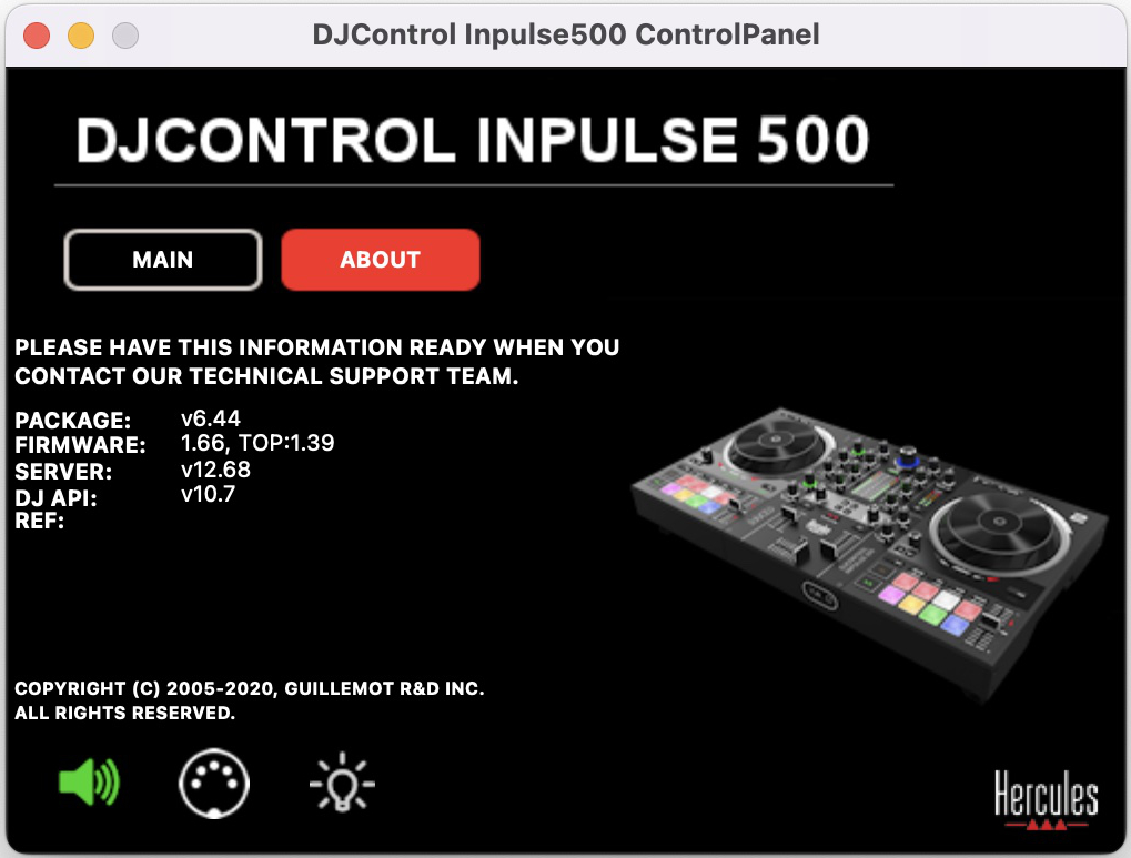

im new to the forum and djing. just bought a djc inpulse 500 and i cant get it to fully work. it connects and the turntables work when i connect it to virtual dj or djuced but no sound and also none of the other keys are working. my control panel also looks different from the ones i have seen posted here before. hoping someone can help! thanks!

- in the control panel, at the about tab, do you see the icon between the speaker and the LED icon turn to green when you move faders or rotary buttons on press on keys.
3) Your control panel screenshot seem perfectly OK, it is not the same panel in Windows and in macOS.
I have pointed your first image to the maintenance bot so that it removes it as one can read your unit reference number and it is safer not to make it public  (each unit has a specific reference number so this number belongs to you).

2.) Yes I can see the cursor moving when I open DJuced. The LED light only comes on/flashes green when I turn the jogwheel. Faders, sliders and buttons do nothing and it does not turn green. When I use DJuced the jogwheels work but no audio out of controller which is connected to speakers and headphones as advised.

3) Another test of DJC Inpulse 500 built-in audio is to click on the speaker icon in the About panel of the DJControl panel: it plays a signal in the front speakers and in the headphones.
