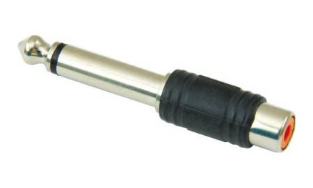

The outputs use standard 1/4" jack (also known as 6.35 mm these days), so depending on the speakers you are using you will need probably need either:
- Two 1/4" Male Mono to RCA
-  1/4" Male Mono to stereo female mini jack
11 Answers

the outputs use standard 1/4" jack (also known as 6.35 mm these days), so depending on the speakers you are using you will need probably need either:
- two 1/4" male mono to rca
-  1/4" male mono to stereo female mini jack
