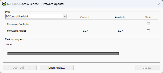

Hello Fifofam,
The remaining test is to try a firmware update.
Please left-click on Windows icon on your screen, select Run and type, with the "
 "C:\Program Files\DJHERCULESMIX\Audio\DJ Console Series\cpl2\firmware\HDJSeries2Updater" -manual
Click on OK
If the controller is detected, you can try updating the firmware in following the on-screen instructions.
If the controller is not detected, I am afraid it is a hardware defect, so
- maybe the defectiveness is only the mini USB connector, and it can be repaired if you know how to unsolder/solder wires on a small printed circuit board
- maybe the defectiveness is elsewhere, for example in the micro controller, and it cannot be repaired.
