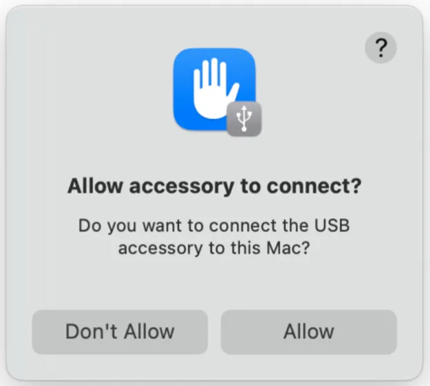

4) Please confirm if on your MacBook you see no USB restricted mode messages?
Ventura displays a message "Allow accessory to connect?" when you connect a USB device, but I think this function is only for Mac chipset (M1, M2) and if your MacBook is a 2019 model, it is still with an Intel Core CPU.

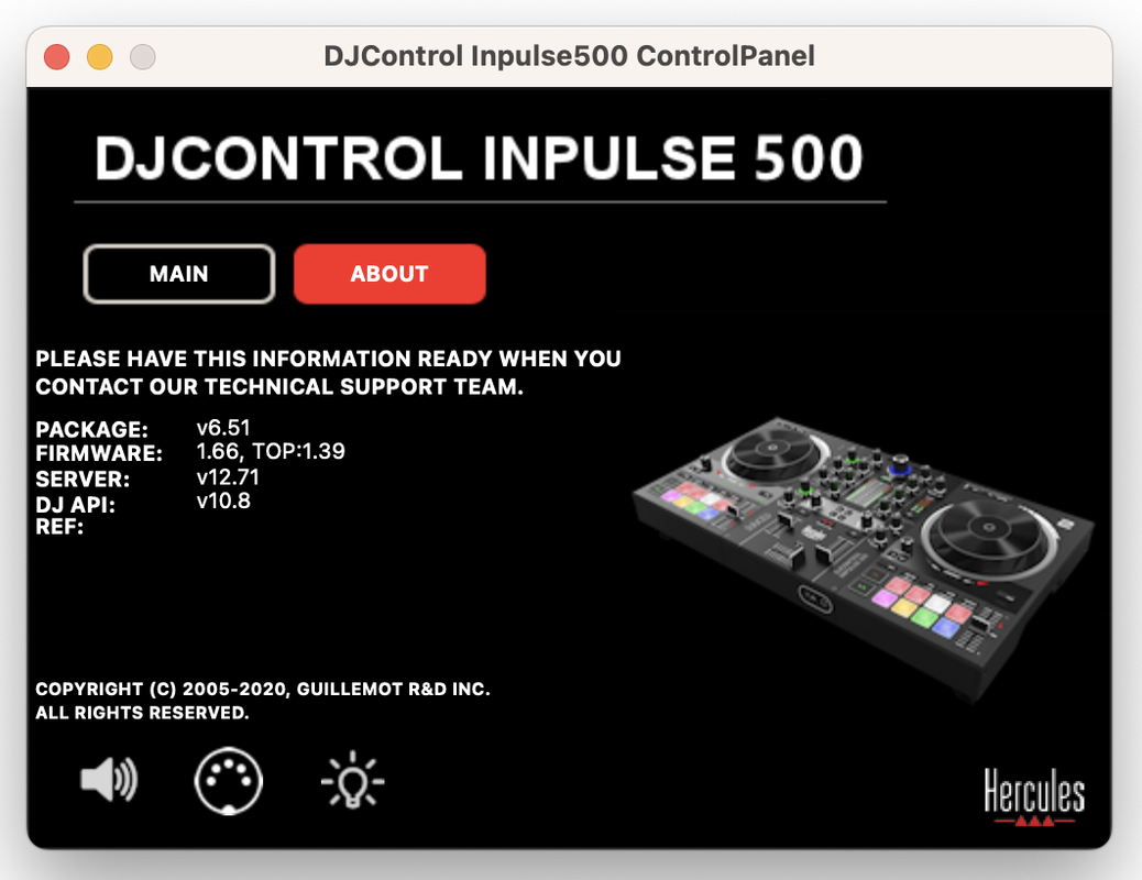

5) Please go in Macintosh HD > Applications > DJHERCULESMIX > DJSeries > DJCInpulse500 > ControlPanel
Run the control panel.
What does it display as Firmware when you go to the About tab?
The up to date firmware is 1.66 Top 1.39
