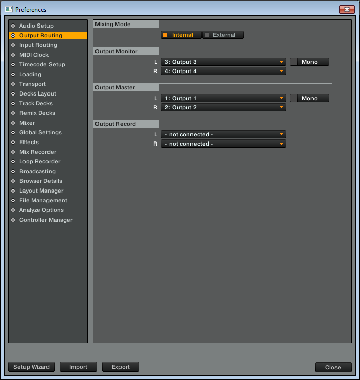

i use the hercules dj instinct with traktor scratch pro 2.6.8.
everything works perfectly fine except for one thing:
i cant hear the tracks only on my headphone. the headphones work, but only if the speakers are playing as well.
i downloaded the hercules manual and i set up traktor correctly. according to the manual, i have to go into some advanced settings, but i looked everywhere and i cant find the software, i have to do this with (its shown in the screenshot below this text). i looked on the cd that came with the controller and started every kind of software, that i could find, but i didnt find it.
i even downloaded asio sig gen, but that even made it more confusing for me, because it wasnt the software i was looking for and i could only select channels 1 and 2 for the headphones, but they have to be 3 and 4 dont they?

      => In Traktor settings > Output routing, make sure you have set as described in Hercules pdf manual for Traktor,
    • Mixing mode: Internal
    • Output Monitor: L: Output 3 / R: Output 4
    • Output Master : L: Output 1 / R: Output 2

The settings in Traktor were like you and the manual showed me all the time.
