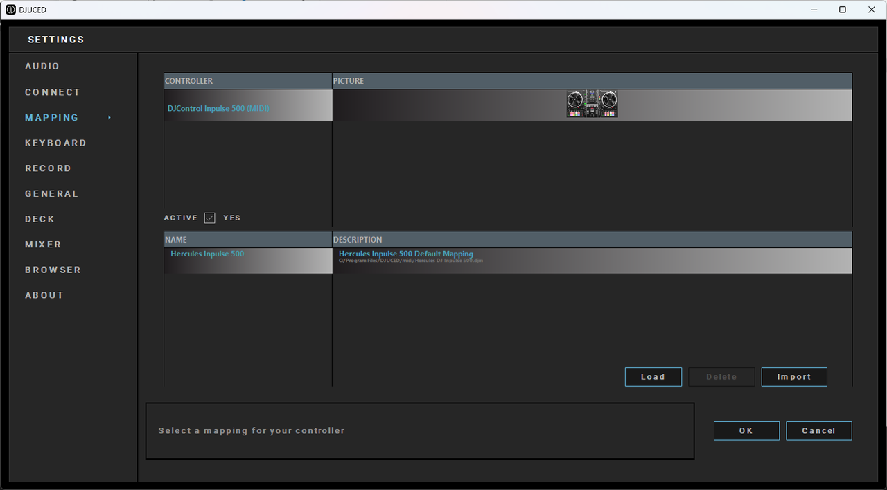

2) Si vous allez dans les réglages Djuced > Mapping pouvez vous vous assurer
a) que le mapping de DJControl Inpulse 500 par défaut est chargé ?
Sélectionnez le mapping "Hercules Inpulse 500 - Hercules Inpulse 500 Default Mapping", cliquez sur Load pour le charger.
b) que le contrôleur est activé (case Active: assurez vous que Yes est cliqué)

I've already made sure that everything is activated including the map, my djuced version is version 6.1.1 build d4003f1bb
In djuced, I can turn the jogwheel and press the modes, but nothing happens when I press the other buttons!

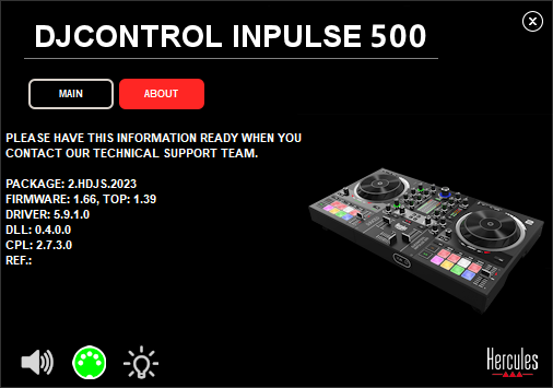

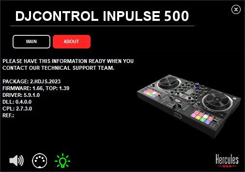

  1. Open Hercules DJ control panel
  2. Go at the About tab
  3. Check if, when moving on the controller the controls which are not detected in the DJ software, the MIDI plug icon on bottom left becomes green.
  4. Check if, when clicking on the light bulb icon on bottom left, all LEDs light on on the DJ controller.
