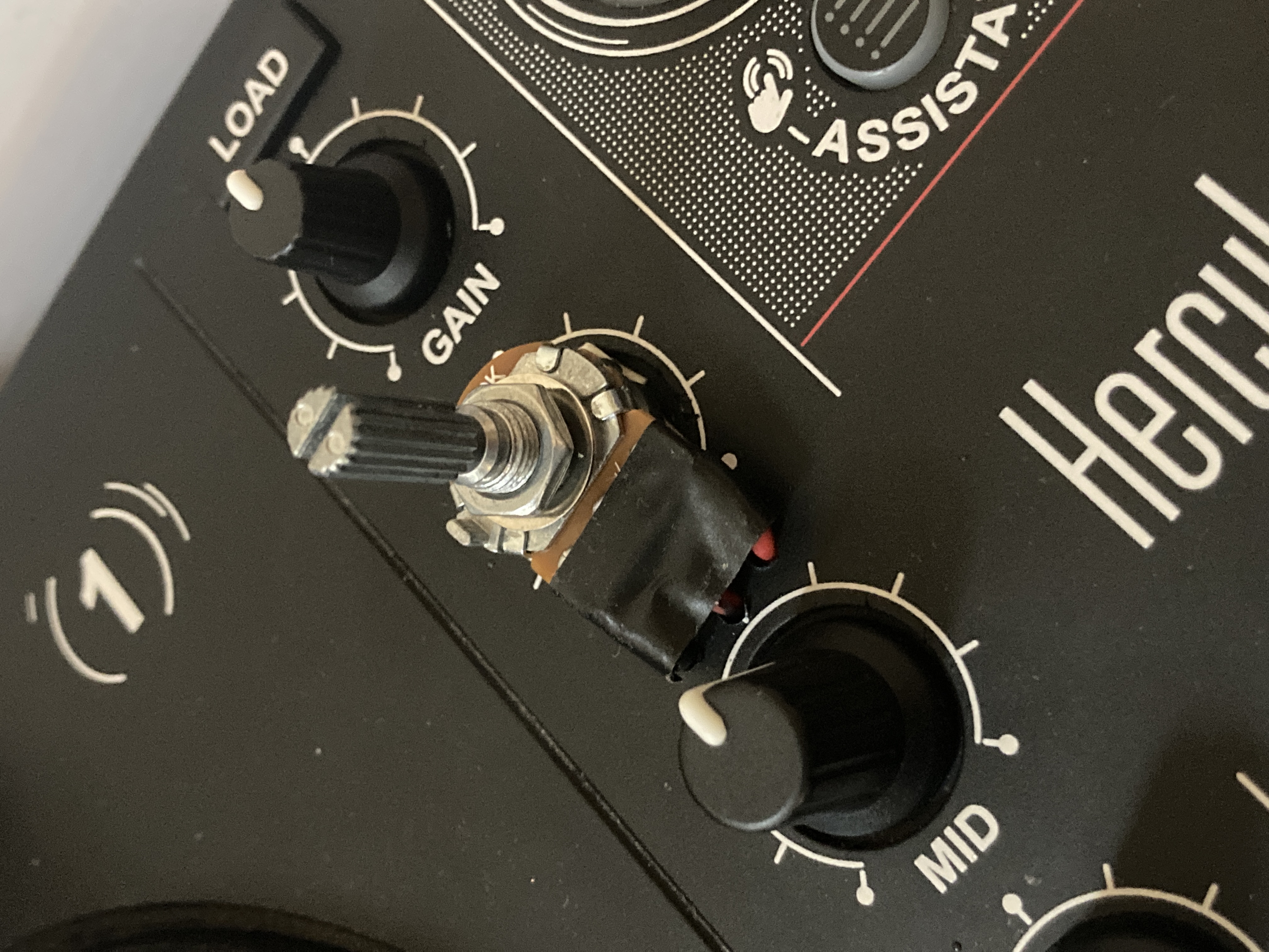

Quick update:
I dirtily replaced the faulty potentiometer with a standard B100K linear potentiometer, and everything is now working correctly without any issues.
The HIGH EQ behaves normally again and the controller is fully usable.
Thank you for the help and the references provided during troubleshooting.
