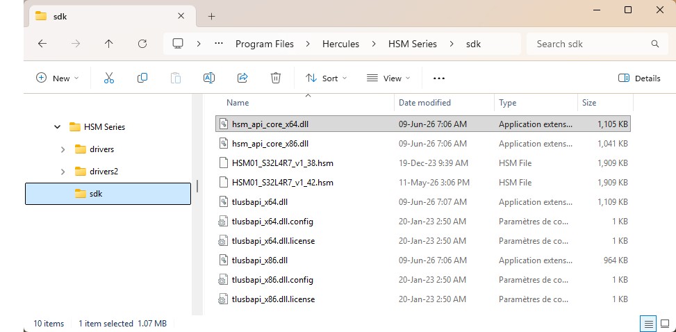

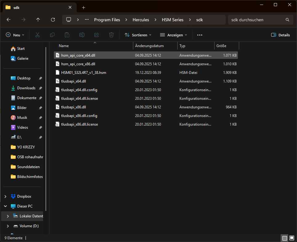

Yes, it looks good, there is one other point I forget to ask you to check
Can you do same capture as this one ?
"C:\Program Files\Hercules\HSM Series\sdk\"
Can you also confirm that the message you have when your Start Stream Control is only  " No device found" ?
You do not have other messages before?

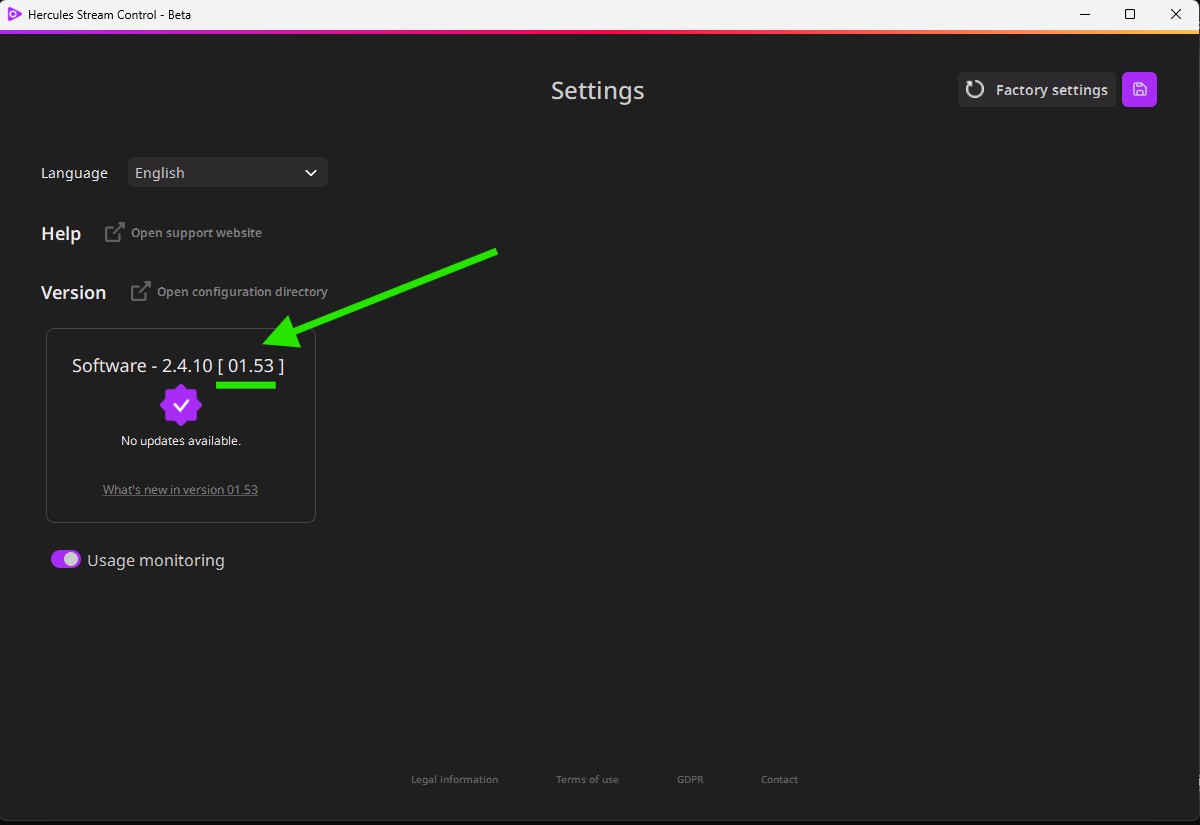

My point of view is that there is a mismatch between the drivers and the application version
To confirm that I need you to do a double check,
Even if the S200 is not detected, you can click on the top right settings icon and get access to more information
Can you do the same capture?

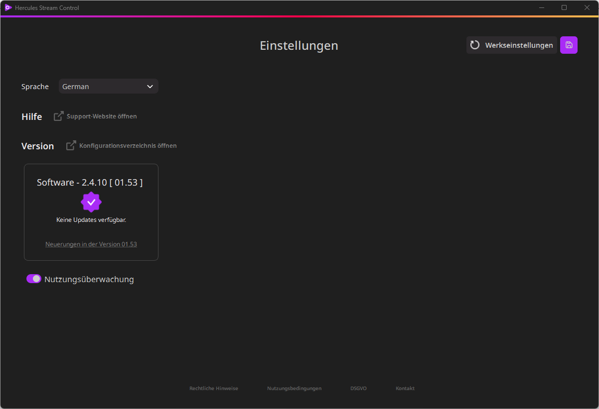

Hello @OLIVIER
I double-checked the versions. Stream Control shows Software 2.4.10 and HSM Series Drivers 01.53, so the application and driver versions appear to match.
I also checked Device Manager: Hercules Stream 200 XLR Control and DFU both show “This device is working properly”. When I manually start boot mode, the Hercules Stream 200 XLR BOOTLOADER also shows “This device is working properly”.
However, Stream Control still only displays “No device found” and does not offer the forced firmware update. No other error message appears.

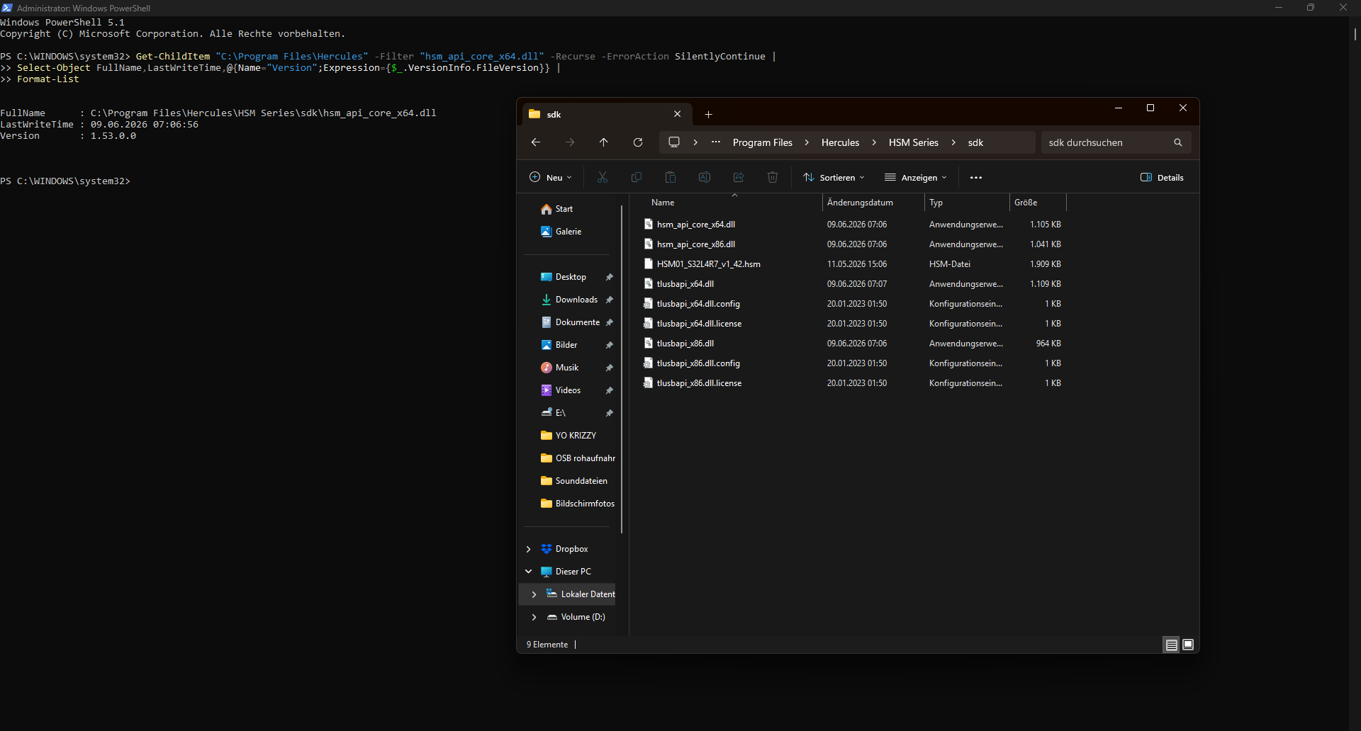

Hello @Olivier,
I checked the currently installed file again.
Path:
C:\Program Files\Hercules\HSM Series\sdk\hsm_api_core_x64.dll
LastWriteTime:
09/06/2026 07:06:56
File version:
1.53.0.0
So the current DLL now has the same date and version as the one you mentioned. However, Stream Control still displays “No device found”, even though Windows recognizes the Stream 200 XLR Control, DFU and Bootloader devices correctly.
The Bootloader also shows “This device is working properly”, but Stream Control still does not offer a firmware update.
