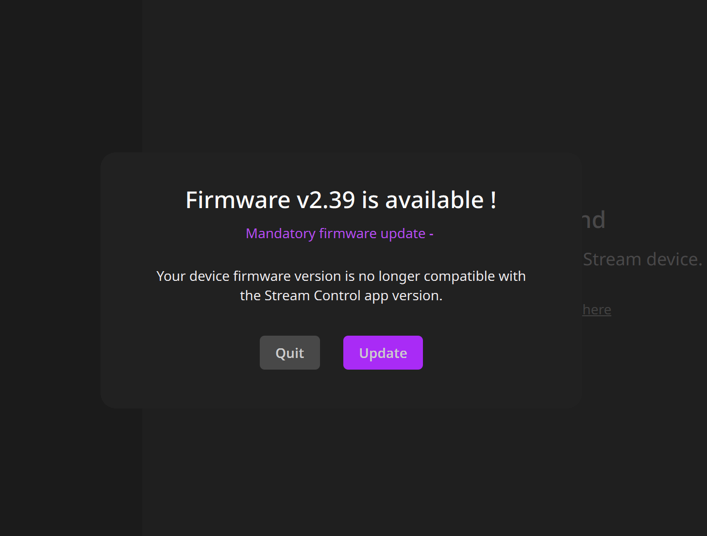

Can you let me know if it ask you to proceed to the firmware update (v2.39) ?
You should have this pop-up

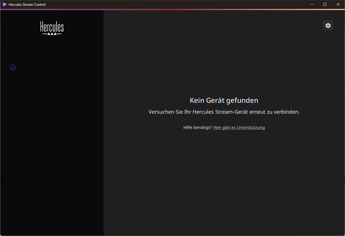

Hello Theo, i did all steps. when i put the device in boot mode, the windows sound appears but stream control says no device found.even it looks like the firmware was downloaded completly,the device restart itself but still get frozen when the pro audio controler logo comes

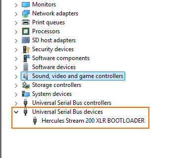

Please open Device Manager and confirm that the Stream 200 Bootloader device is installed correctly, as shown.
If there is an error on this device and/or is is not present and installed properly, it will obviously not be possible to properly proceed with the update.

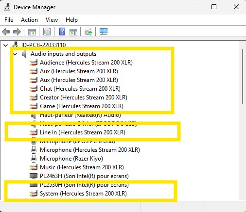

Hi,
Let us restart step by step:
1) Check Firmware is OK
- If you have the Stream 200 XLR logo displayed on your device, it means you have a valid firmware
- So no need to do other firmware updates for the moment.
2) Then check that Audio driver are correctly installed
- Go in the device manager and check that you have same device like the attached picture
- If not it's a drivers installation issue

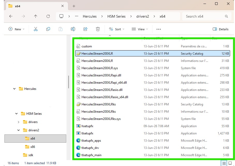

3) Check that all files are well copied ( sometime antivirus can block some )
- Go in this folder and send a capture of all the files present like the attached picture
"C:\Program Files\Hercules\HSM Series\drivers2\x64\"
- If some are missing we will need to restart the installation, but before that we need to manually uninstall the Drivers and the Stream Control by going in Windows Add/Remove application

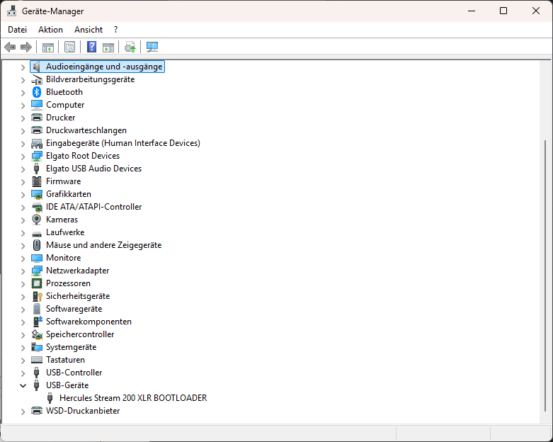

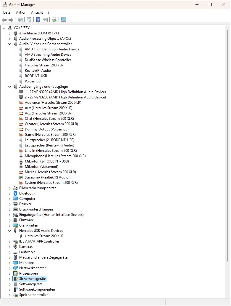

Hello Oliver, thank you in advance for your quick efforts to help me.

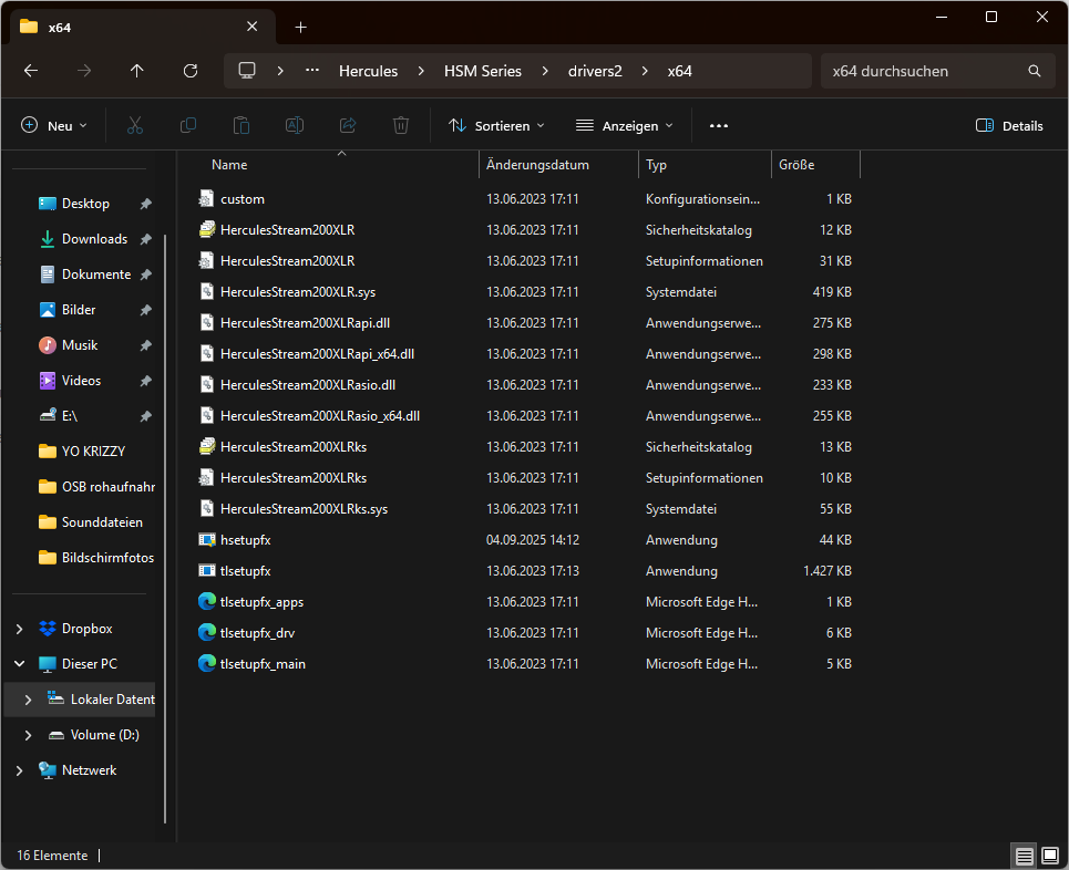

i checked and everything seems good. tako a look at the screenshots
ups, failed the second screenshot
1

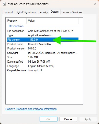

What is strange is that  in previous capture Screenshot-2026-06-22-141747.png
The date of the file hsm_api_core_x64.dll  is 04-09-2025 and it should be 09-06-2026
1
What I find strange is that in the previous capture your have done Screenshot-2026-06-22-141747.png the date of the files 04-09-2025
And on mine is 09/06/2026.
